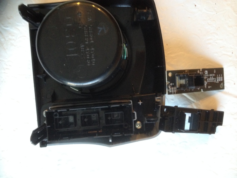

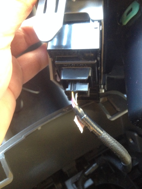

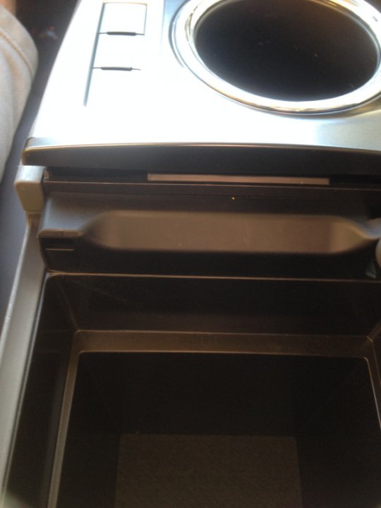

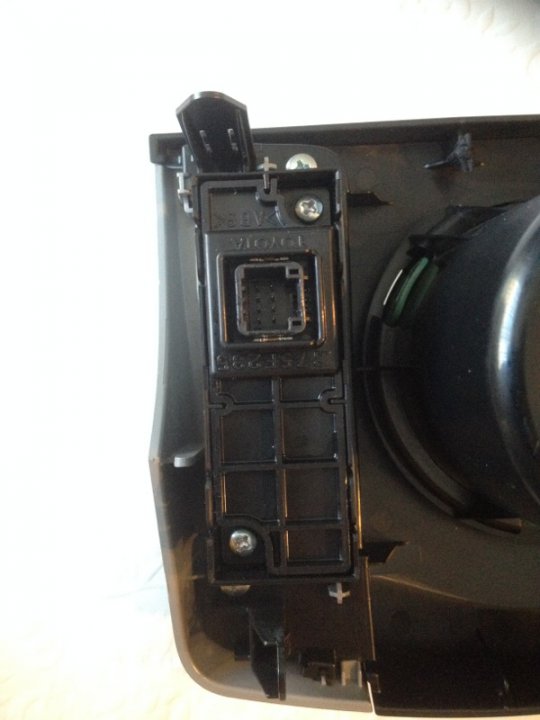

    Just got done cleaning this mess this morning...attached some pictures if y'all are interested.
    thank
    pull from back - like mentioned above, only a few clips are holding it down.
    disconnect unit...
    remove screws
    remove cover and remove electrical unit (dont know what's its called)
    washed the housing with warm water and soap. gently cleaned the electrical unit with alcohol.
    remember to clean the center console with warm water and soap (that took a lot of time to clean up.)
    Good luck and hopefully this helps.
    srisan likes this.
