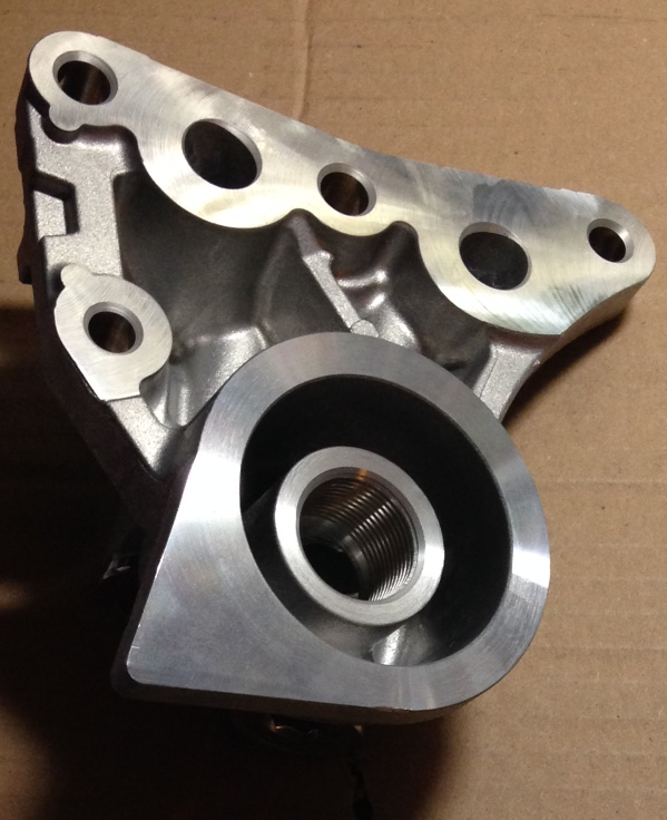

    It's funny between the two there is only like a 10 cent price difference..lol I'd like to use the newer revision honestly but the 15609-0T060 is what is used with all the how-to's online/youtube for this. I'd be super annoyed with myself thinking I'm smarter than that and getting the 15609-0T070 and finding out that something has changed or the placement of holes/oil orings..etc. were slightly off...lol
    I typed in the 0T070 part number on the lexus site and look at this:
    But if I put in the 0T060 part nothing pops up. The even funnier thing is that this change appears to be on 2017 CTs and not previous years.... soooooooooooo, I'm more than likely going to order the 0T070 part number that's mentioned in this thread because it's the newer version and it's coming up on the diagram above...

    Welp quick update. Got the stuff on the weekend. Super fast shipping from McGeorge. They are in Richmond VA, I'm in Gainesville VA. But they are still cheaper by a lot compared to the dealer that is 10 minutes from my house... go figure.
    Got the revised part number listed in this thread and everything appears fine. I do like the triangle part that comes to a point so when you unscrew the oil filter it will drip down and make cleaning easier. This was a nice revision. The 15609-0T060 part number that has been floating on the CT forum and FB group all reference that number so I'm telling them to get the newer 15609-0T070 part number.
    Also plan on using the larger oil filter YZZF1. Has no clearance issues with anything.
    Coupled with a fumoto valve and now oil changes are tool-less nothing special required! w00t w00t!

    As far as I know, for the part where the base of the oil filter makes contact with the casting:
    • 15609-0T060: is fully round.
    • 15609-0T070: has a tear-drop shape to help direct the oil when removing the filter.
