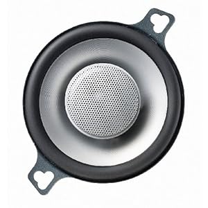

    Another option - the Infinity Reference 3032CF 3.5" speakers are also on Amazon (reg $99 - now $26 + shipping)... It's been reviewed fairly well......

    FWIW, the Infinity speakers are out to 21Khz. I don't know about you guys, but my hearing was tested to top out at about 19K, so the difference between 21K and 28K would be lost on me anyway.
    Also remembering that we're not in our living room either, so ambient sounds would easily mask the difference if it were audible in the first place.
    Another interesting factor is that the Infinitys are more efficient than the Pioneers (88dB/watt vs 91dB/watt). That's a pretty significant difference, along with a 2 ohm impedance (which would make it a good fit in the JBL system which uses a 2 ohm squawker)

    I just finished replacing my Dayton Audio RS75-4 3" sqawkers:
    With the 3.5" Infinity 3032cf's:
    These are quoted as 2 Ohms, but it's Infinitys "True 4 Ohms." I used the 100uF cap that came with them to set the highpass at 400Hz for the 3.5" woofer.
    At 91db/W-m, these are a lot louder than the Daytons at 83dB/W-m and they extend to higher frequencies too (21kHz as mentioned before). Can't go wrong for $40 shipped. They sound awesome, and all vocals and higher frequencies come way out at the base of my windshield now.
    Install isn't very clean as you need to do some minor plastic trimming (but nothing that destroys how the old speakers would mount back up), and now I am going to remove the tabs on the black grille covers and affix them to the dash with just velcro. Shouldn't be able to tell once it's finished, and I can always buy new grille covers if necessary.

    After thinking about it a little more, I will just make some simple aluminum plates, cut out for the ~4" diameter speaker size, and cover them with UV-treated black cloth. These will just sit on top of the dash and be held in by velcro.
    The reasons are:
    1) I would like to angle my sqawkers and make them more effective, and will need all the space under the grille to do so.
    2) The OEM grille only has an ~2" diameter opening anyways for the sqawkers.
    Dave
