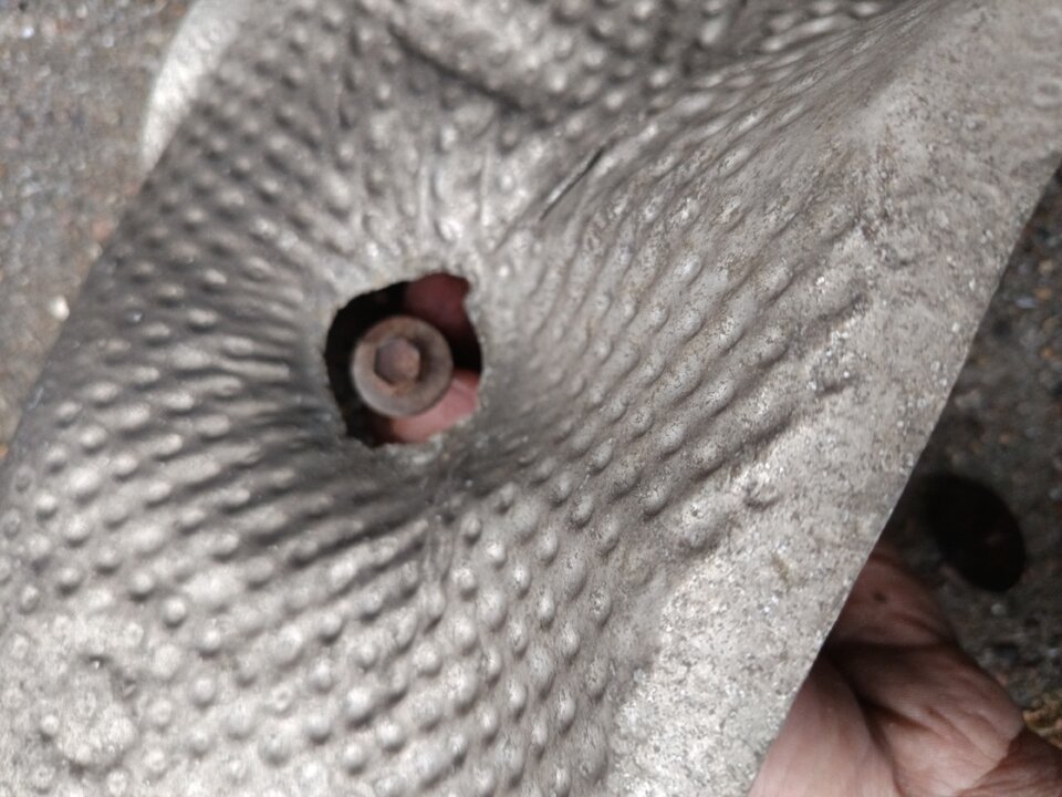

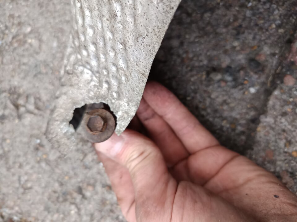

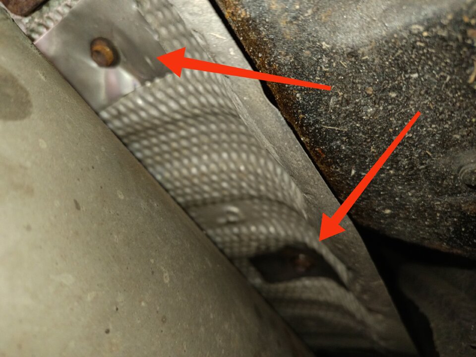

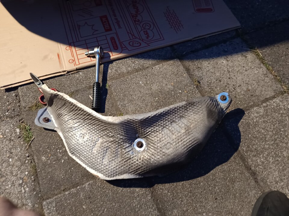

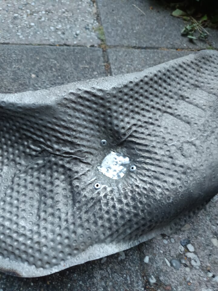

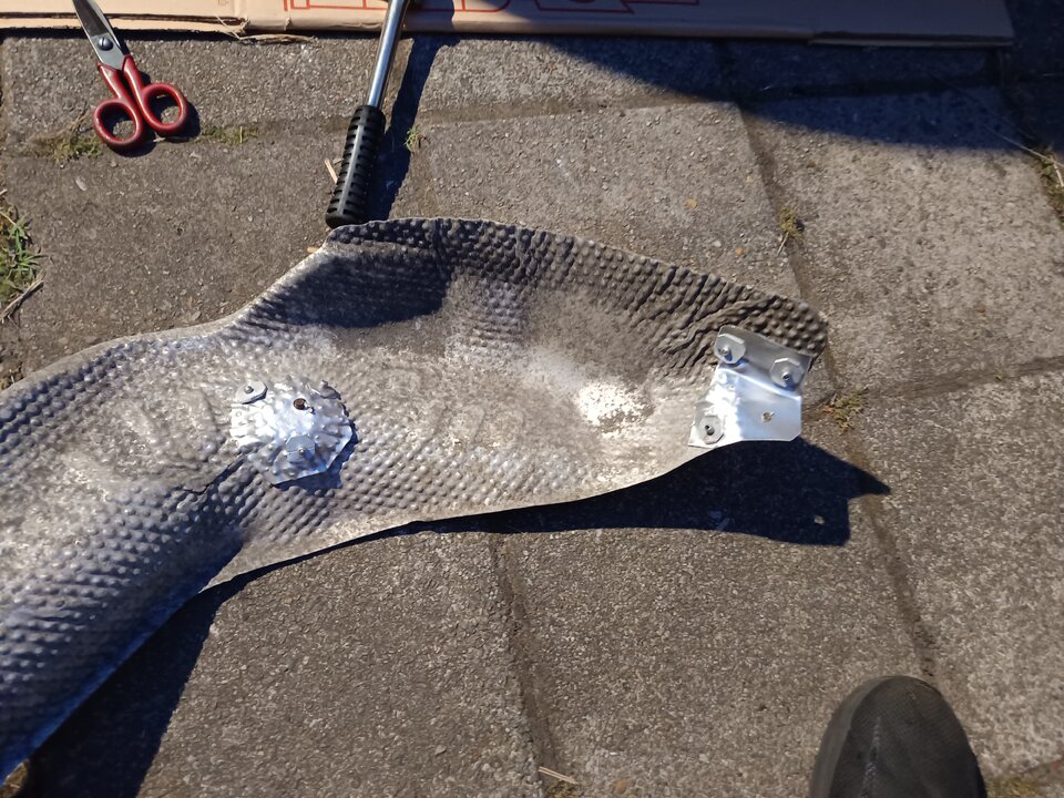

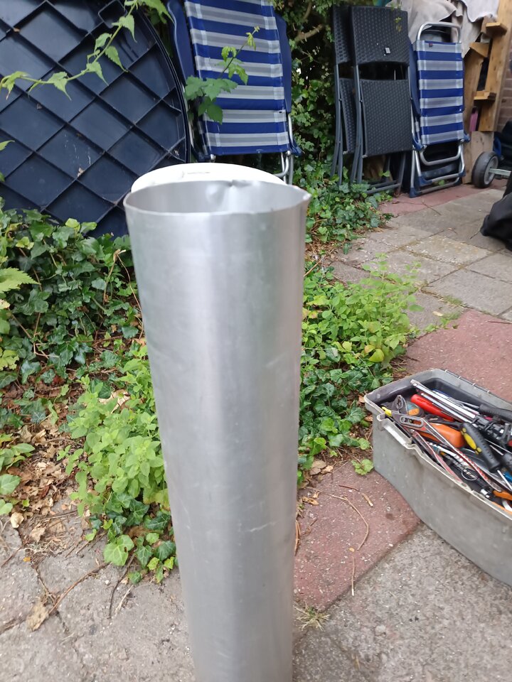

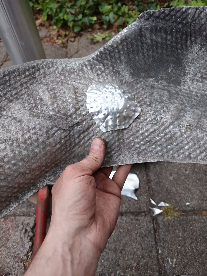

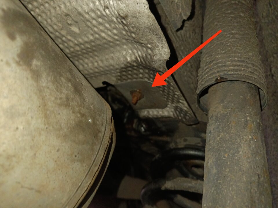

    I also thought about the heat shields, I mended them a week ago, but the sound persits, it' s really high pitched, like the sound of worn drill trying to perforate some hard metal, but quite hard to hear, and I think it comes from the flywheel location.
    When MG1 engages at S1b the noise stops, it' s like it absorbs the vibration.,
    I was tempted to spray some wd40 on the flywheel springs if they can be reached from the plastic cover , but what if the cutch starts slipping?
    Here are some pictures of the mended heat shields.

    Do not spray any lubricant on the clutch surface!
    You can remove the lower cover and see if you see any metal parts at the bottom..
    You can also take a long screwdriver or metal rod and touch it to your ear and touch around the
    area you hear the sound. Using it like a stethoscope.
    Abarnabe likes this.
