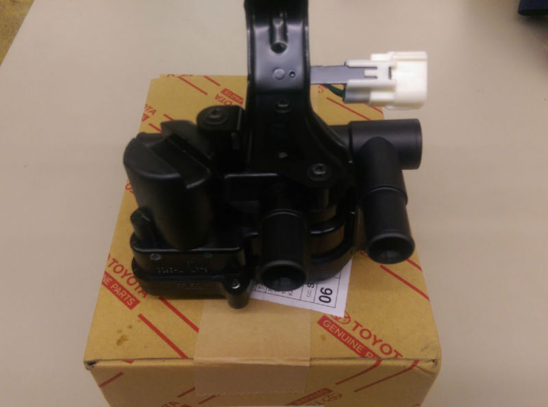

  5. ColoradoCrow
    ColoradoCrow Senior Member
    Sep 2, 2019
    1,108
    464
    Leawood, KS
    I
    [​IMG]Like this one????
  6. jimolson
    jimolson Member
    May 1, 2006
    162
    63
    Indianapolis, USA
    Thanks, guys, for catching that error. I was confusing the inverter cooling loop with the engine cooling loop.
    Physically where is the engine coolant thermal reservoir’s electric pump? Is the pump constructed differently from the inverter coolant pump?
    And the coolant diverter valve I replaced years ago on another Gen 2 has a failure mode that sounds a bit like a work ABS hydraulic pump as it “hunts” for the correct feedback signal?
    This car with the Ah-ooo-gah noisy water pump also exhibits the perpetual diverter valve hunting noise.
