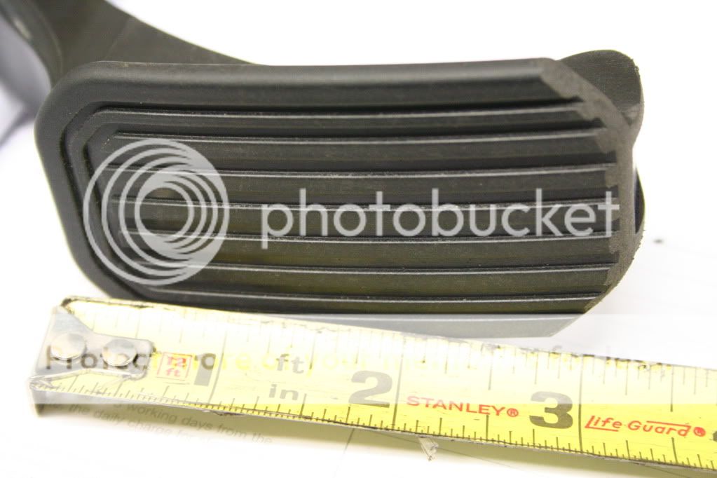

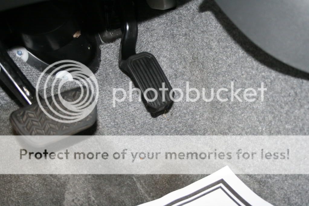

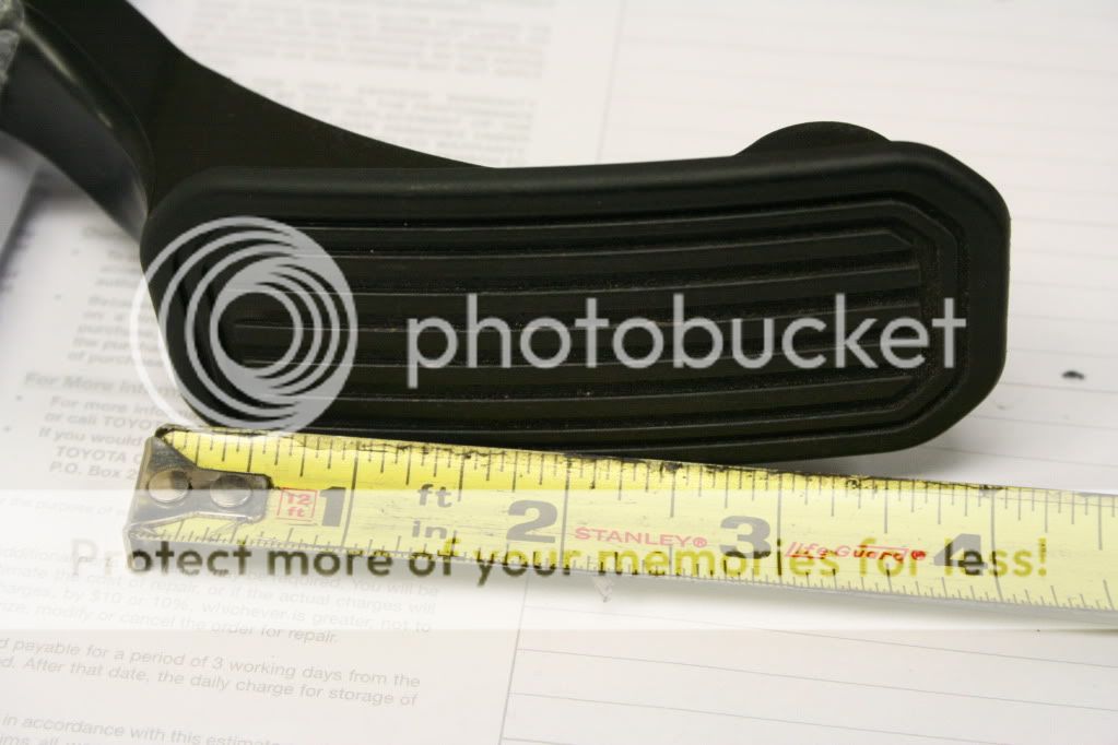

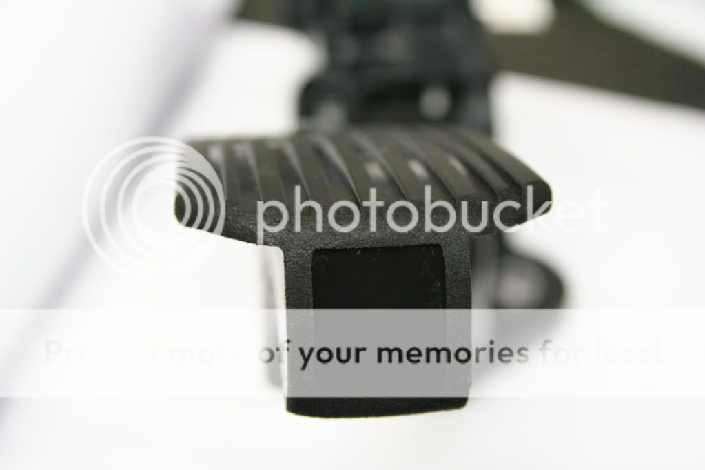

    Prius pedal pics!!
    Before cutting.....
    After cutting and sanding...
    The raw surface...
    After finishing with some FIPG for color...
    And reinstalled back in the car..... Please feel free to offer opinions.... I am rather thick skinned:D... However, in my honest opinion, this is NOT one of Toyota's finest hours.... This repair seems slightly...... ummmm Mickey Mouse?

    Yes, but that is better than the use of nylon ties to secure the floor mats. I thought that was totally a half-a__ approach.
    I don't feel a great urgency to have the accelerator pedals on my two Prius cut, as the tech doing the job may not be as careful as you.

    HA HA!! Yeah.... didn't ya just LOVE the idea of punching holes in floormats and zipstripping them to the seat frame!!! We flat out refused to do that. Instead we removed the mats to the trunk and waited for a slightly better fix... Cutting the pedals does do the job.... But it does take a bit of practice and a steady hand to keep them looking nice.:rolleyes:

    Too bad Bear did not take a few more photos showing how he cut the pedal down and sanded it. That might become the basis for an interesting video like the one Toyota produced, showing how the metal shim was inserted into the accelerator pedal of other Toyota models.
