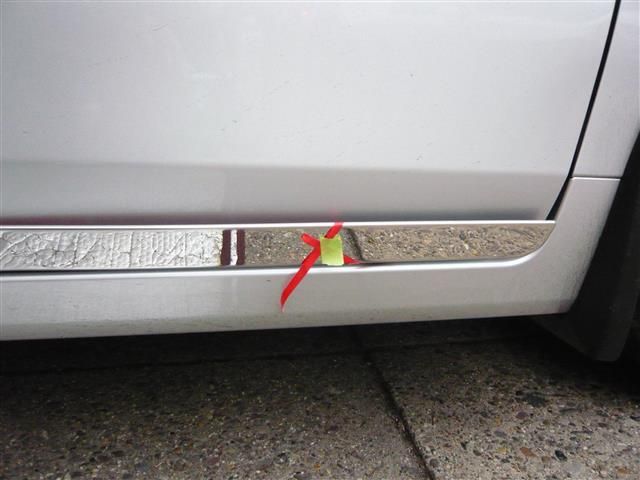

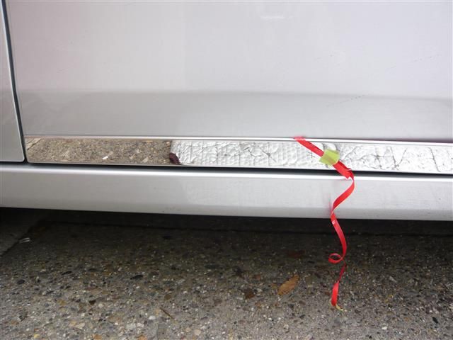

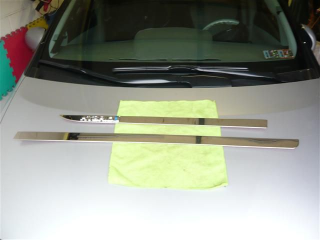

    Order them from Rakuten Japan, which is a lot cheaper than eBay.
    When I took them out of the box, I thought they're the wrong sizes because they looked too l o n g. But of course, I was wrong!

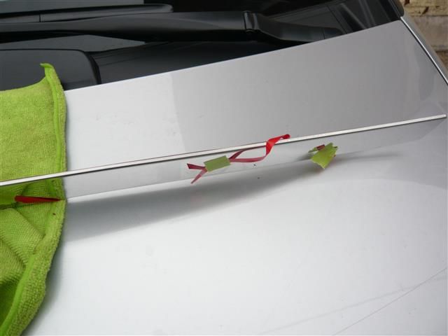

    I believe it came with Japanese instruction, which I couldn't read.o_O
    Hope the pictures below help. Make sure you clean the door surface well and finish with alcohol or adhesive promoter.
    Only peel off the red waxy tape enough to be taped with masking tape. You may want to make the mark after try fitting too.
    At first only put just enough pressure for the piece to stick on, then and only then you're sure it lines up, pull the red tape s l o w l y and press home from middle section outward to prevent bowing. ;)
