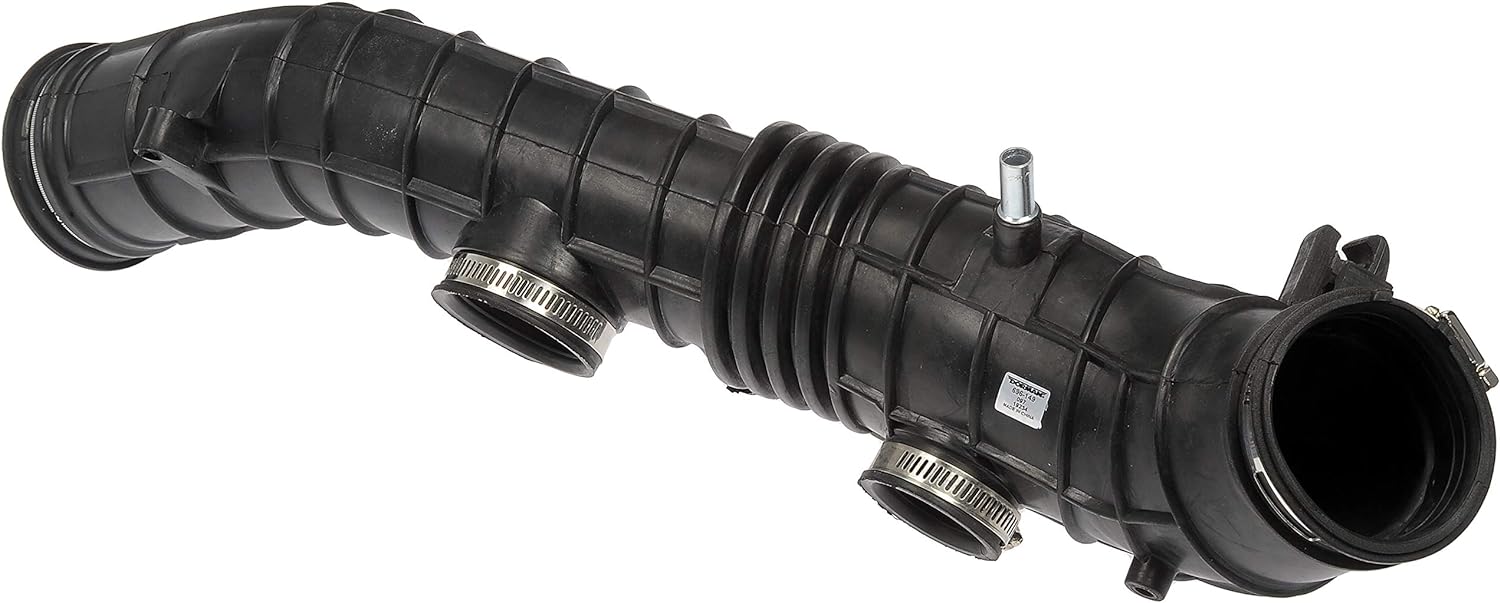

    Although I have never done that on a Prius I have done it on other cars. All the plastic before the throttle body comes off and gets a thorough cleaning and inspection. Sometimes one finds broken bits between the air filter and the MAF (or some other sensor) letting unfiltered air in which isn't immediately obvious when the intake is assembled on the car. Especially when it looks something like this:
    Breaks at the bellows (roughly in the middle of this part) often open downward and cannot be seen without a flashlight and a mirror when the part is on the car. Other times the junction between two pieces has popped open a little, especially if the "metal rubber band" sort of pipe clamp (I think there is one all the way on the left of the image) is used, because those can break and fall off.
    Also check any vacuum hoses along the path. A small crack in one of those upstream from a MAF can foul it.
