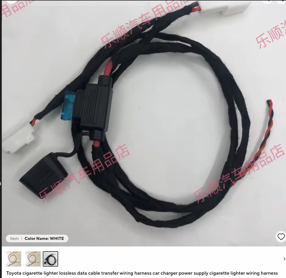

    Currently I have a power supply running plugged into a 150 Watt DC to AC inverter that charges the Solix from the 12V power outlet in the front. I am in the process installing a 12V outlet in the hatch so I don't have to run a cable down the middle of the car. Waiting for a couple of parts from impex and Aliexpress before I can complete the installation of the 12V in the hatch. Like this harness I learned about from soft_r's post #1.
