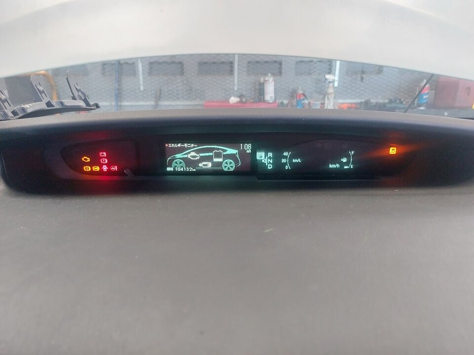

    A little bit of the history of the car. The car driven into deep water. Drove 2 days without a problem. After that it wouldn't start. They tried to get it running again but didn't succeed. The car was left. I purchased the car without battery pack, without abs module and pump. I had some spare parts from a CT200h. I was able to use the brake pump and module and also the battery pack. I realized today that i had purchased the new battery pack for the CT200h pack from the Netherlands. When i replaced the pack the CT200h also didn't want to start because of a different voltage module. I looked up what the number of my Prius should be and it differs from the one i have now. When i clear the fault codes i get this screen for about 5 seconds Prius dash.jpg

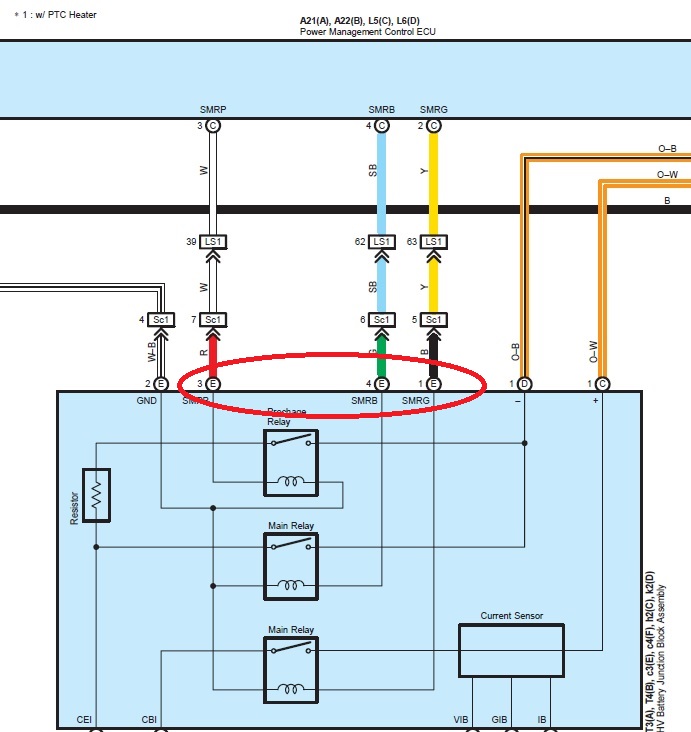

    PMCE diagram.jpg Received the battery fan motor today. No more fault codes except for the ABS module. The triangle is gone but still no start.
    The faults still present are
    C1203 ECM/EV communication circuit
    C1242 Open circuit IG1/IG2 power source
    C1345 Linear solenoid valve offset
    I can hear that the relay module on the hybrid battery is not being activated. When i measure the current on the plug that activates the module there is no power on the wires. See the circled part in the picture. Tested the relays and all are working fine.
    Will a faulty ABS module prevent the car from starting. If i would disconnect it will it still start, turn to ready?
    Could a power management control module be faulty and not give a fault code?
