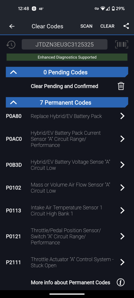

    I uploaded codes already. Here they are again in the image.

    Your code screenshot in that post shows nothing but permanent codes. Permanent codes are around because the corresponding issues were detected at some time in the past. They will stay around until you get the engine started and make enough normal drives for the ECM to convince itself all those things are now fixed.

    These are the codes it gives.
    Not sure how many of those are "old" codes that need to go away after you drive the car certain distance..
  19. ChapmanF
    28,621
    18,954
    All 7 of them ... that's what the display means by 'permanent' codes.
