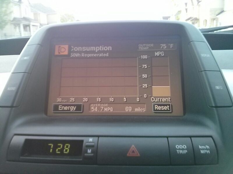

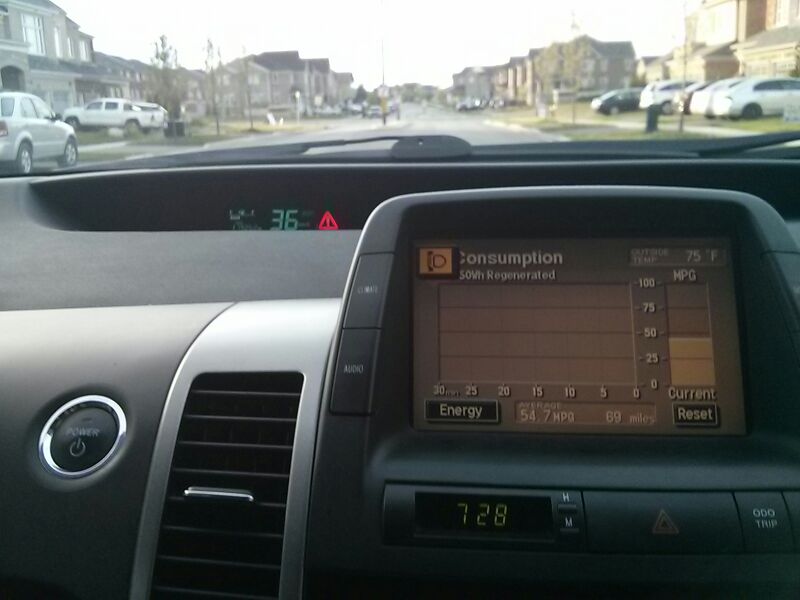

    Been happening sometimes on startup
    Just a few min of driving from a cold start I Get an audible chime, red triangle exclamation symbol stays lit. "Problem"shows on MFD then a yellow icon shows at the top left corner appears.
    After driving a few minutes the red triangle and yellow symbol on MFD disappear.
    2004 prius
    no codes logged on the scanguage ii
    Background. Bought car used 1 mos ago 117mi unknown battery history.
    12v under load in maintenance mode is usually 13.8v seen it dip to 13.7v, tried with and without headlights as a load system voltage at 13.8v
    any ideas?

    Took photo at last time of occurance (see atta.anyone experience these sattached)ysmptoms?

    headlight position sensor. its super easy to replace. located in the rear of the car by the driverside rear axle. it attaches to the frame and the suspension. it adjusts the position of the HID headlights. the previous design was known to have problems allowing moisture into the sensor corrupting the contacts. its nothing major but it does cost between 190-300 to replace depending on the dealer for the part
