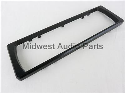

    I am in Cambodia and couldn't wait for 7-days of ebay shipping, so I went to a local market where I get second-hand connectors, from different parts of the world :) That is why I couldn't rely on colors, needed to know exactly who is who.
    Later on I realized the colors do match between Pioneer and connectors from the market. But stock Prius connectors' colors do not match absolutely :)
    Anyway, the installation gone smoothly. Sound quality is incomparable.
    The only thing I would advise to others who want to run the installation on their Prius: make sure the aftermarket radio has a detachable bezel. Mine had a fixed one and that was a super painful thing.
    This is my radio, bezel is fixed, can't be removed:
    That is a normal bezel for other radios:
    I needed to cut my Prius panel with a semi-transparent cover heavily to fit the bezel. That took me 2 days after work. And after that I have a surprise - the cover doesn't close, it meets the bezel before closing and now I need to cut the cover...again.
    I will post the final photos of my setup when done.
    Hopefully today.
