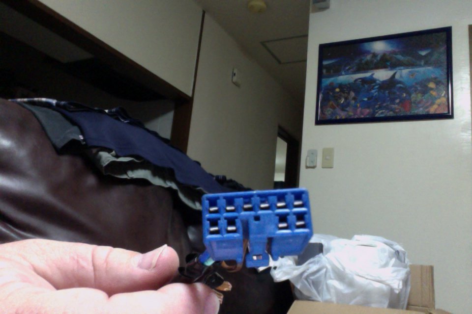

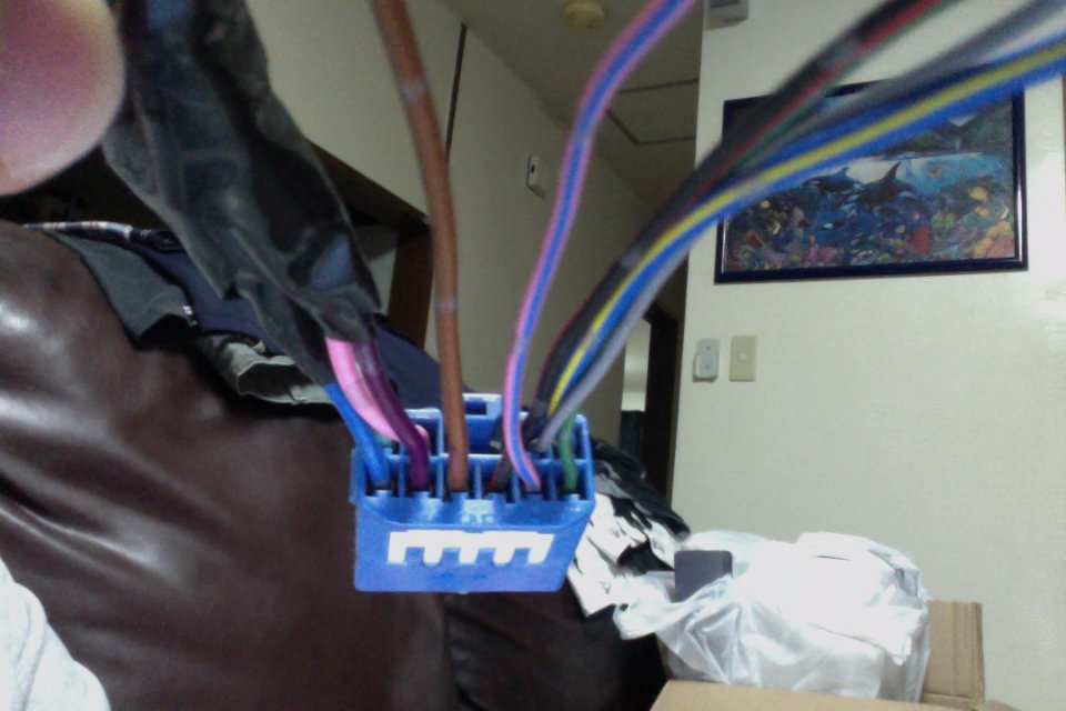

    Did you ever figure out which pins of the oem harness are used. I just went and cut a harness out of another Toyota to avoid ordering the BHO 1761 and need to know which three wires to use.
  10. cww
    cww Junior Member
    Nov 21, 2013
    2003 Prius
    Here is what it looks like.

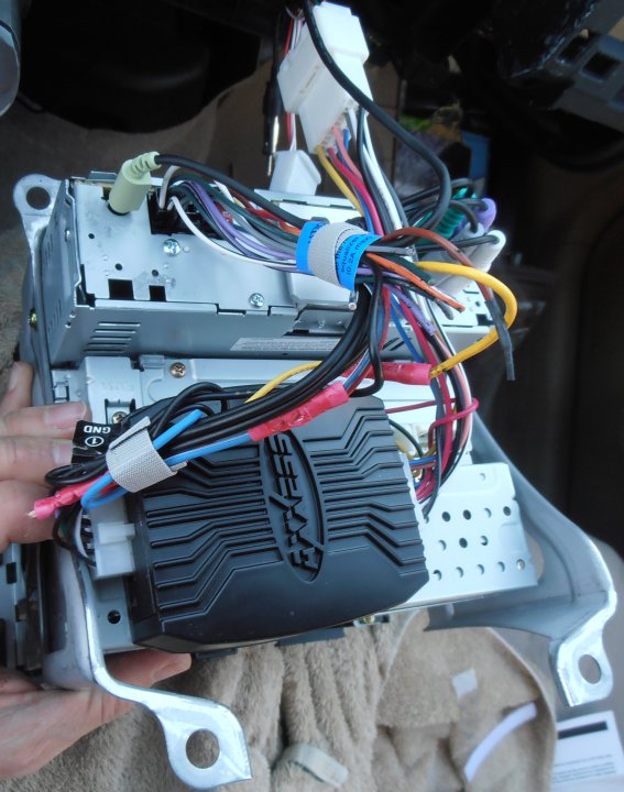

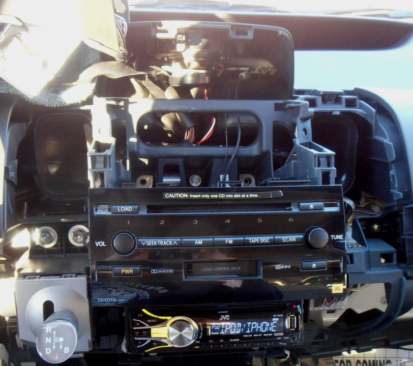

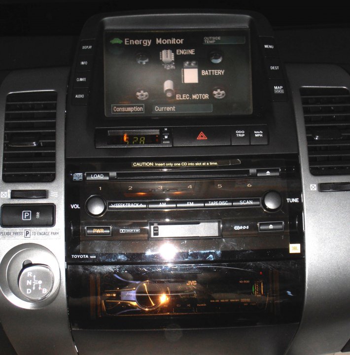

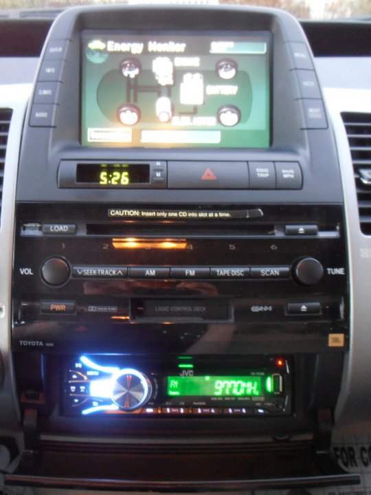

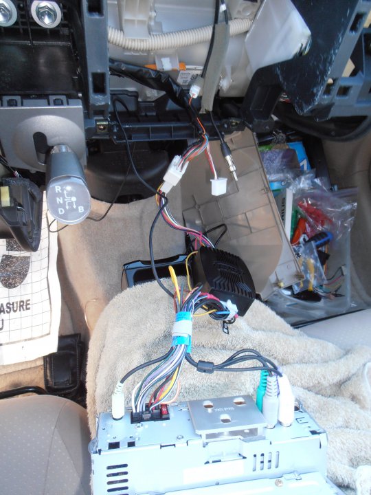

    I just finished a stealth installation of a my JVC KD-R530 aftermarket radio in my newly acquired 2005 Prius (my first mod!). Thanks to all the information available here on PC, I was able to complete the job with only minimal issues. I have JBL system, so I had to buy the TYTO-01 amplifier interface to make it work. Here's some photos from the install:
    The door closes nicely with the faceplate attached (y)
    Thanks again to everyone on PC for all the information that helped me do this installation successfully!

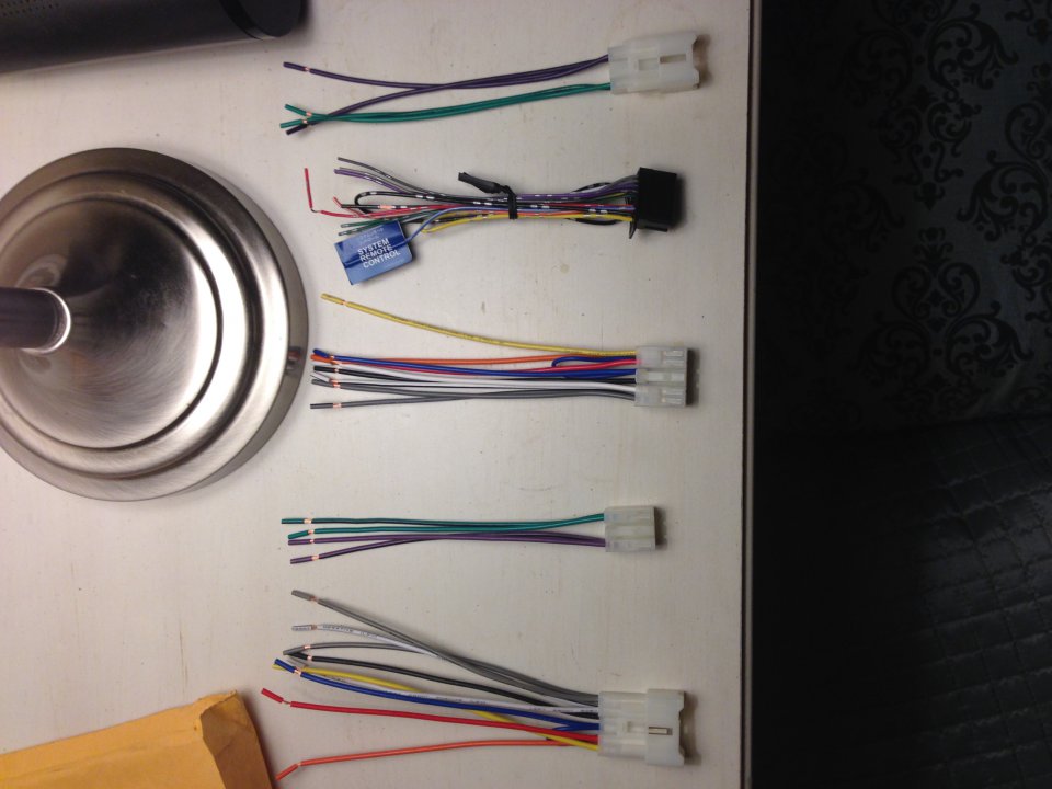

    Okay can somebody please help me here as i am a bit confused. Sorry, I'm new to this type of stuff. So I have 5 harnesses here. And in the video only 3 are used? Can someone tell me which harnesses in this picture I use? Sorry if it's a dumb question
