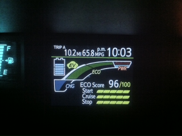

    It's difficult to say the least, especially when keeping pace with traffic. Here's my best; got it a couple days ago actually.
    Maybe I'm missing the point here, but why would you want to put your C in neutral to coast anyway? It's really not even neutral.. It's got a CVT so it's always engaged regardless.. At least, that's how I understand it.. Placing it in "N" to bypass some of the built in safety measures just to go a bit faster down a hill doesn't sound like it pays long term dividends to me. If you want to go faster just use the gas pedal...

    I've gotten Start score of 100 and gotten it to stay at 100 with cruise for 6 seconds... after that, the cruise score goes down, even though I'm staying at a steady speed on a flat road. It's confusing... (n)
  15. steveoknievo
    steveoknievo Member
    Dec 4, 2012
    225
    79
    17
    I believe it rates your Cruise score on how consistently you hold your throttle position. If you do change amount of throttle, how gentle you go about it, etc. It's not about steady speed but throttle I have found. Smooth and steady changes (no feathering of the throttle) and slow throttle position changes when speeding up or slowing down (YMMV)
