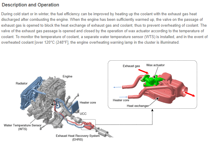

    So does the Prius, starting with gen 3. The one in gen 4 gets posted about here when it springs leaks. (For whatever reason, the gen 3 one didn't seem to do that as much.)

    Is it an actual air (exhaust gas) to water(coolant) located in the actual exhaust system or an EGR type system? The Niro actually uses both.
    I am not familiar with the newer generation Prius.

    If it weren't, I wouldn't have mentioned it.
