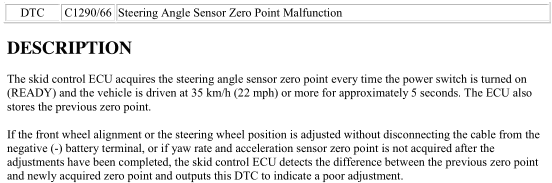

    It may help if you explain what "paperclip method" you used to do your "zero point calibration" and where on the internet you found it. There's at least one bogus youtube out there and people keep finding it and then talking about "the paperclip method", which then of course gets other people thinking there is one, and we keep having to get past that to be able to help.
    The steering angle sensor doesn't have any 'method' you have to use to find its zero point. The skid ECU figures out the steering zero point every time you start the car and drive straight ahead for 5 seconds. When it can tell you're driving straight because the wheel speeds are the same and the yaw sensor says so, whatever number the steering sensor has just then is obviously the zero point. So there's not much to fuss with there. You get a C1290 code if anything goes wrong with that. That doesn't seem to be one of your codes.

    It does sound like the steering angle sensor itself might be kaput and need to be replaced. But I wouldn't totally give up on it before getting the acceleration sensor and brake solenoid properly calibrated again. The C1345 and C1336 and maybe the C1203 should go away then. You get C1203 if the skid ECU isn't sure it's in the right car based on what it hears from the power management control ECU, the body ECU, or the yaw/acceleration sensor, and before the brake solenoid is calibrated.
    As you saw above in how the steering angle is self-calibrated, it depends in part on the yaw sensor to know when the car is going straight. So once you get the yaw sensor calibrated again, you can always try driving 22 mph straight for 5 seconds and see if the angle sensor zero gets learned again. If so, happy days, and if not, it probably needs replacement.
