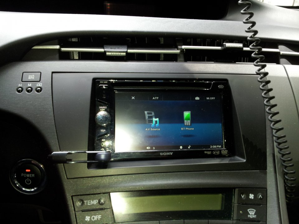

    recently installed a new Sony XAV - 64 BT in my '11 Prius 111
    loved the bluetooth in my BMW so had to have in the P111
    problem is this is the 2nd attempt at using a steering wheel adapter to use the stock P111
    steering wheel controls.
    previously had a Soundstream vR-652NB with exact same trouble...the adapter was iffy at best
    and ultimately the installer gave up with frustration
    otherwise...NO problems with my steering wheel controls...
    I MISS MY STEERING WHEEL CONTROLS of the radio !!:cry: :cry:
    has anyone had any similar experiences or have an ideas as to why this happens.
    not sure of the exact adapter...but I'm told was a universal one..that the installer had "in stock"
    anyhoo...thanx much !!
