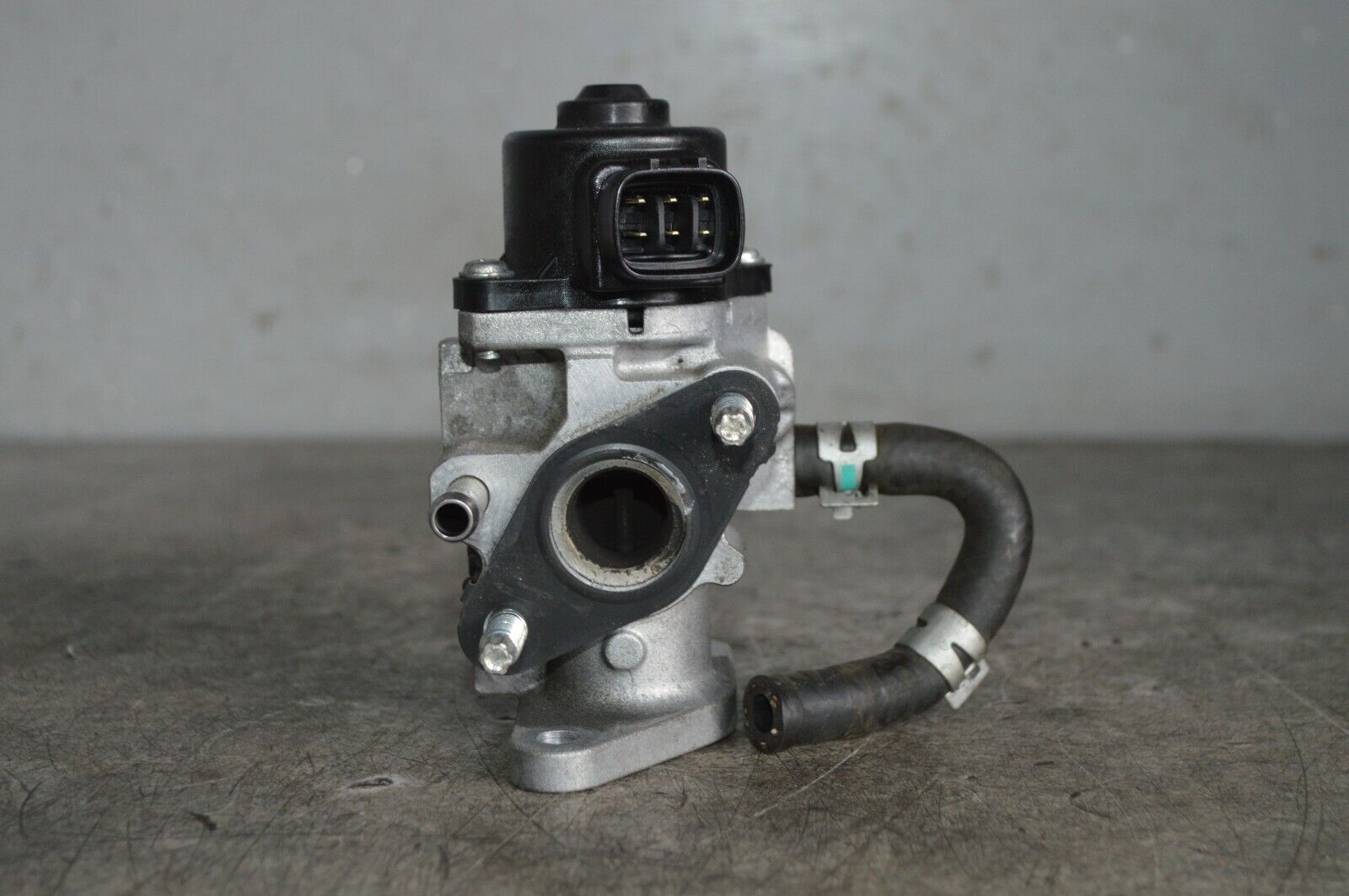

    I couldn't help noticing that the Prius c (and Yaris, apparently) EGR valve adds coolant hose nipples for cooling the valve itself.
    They seem to have concluded at some point that cooling the valve directly is a good idea, whatever the condition of the EGR cooler.

    27,557
    18,149
    EGR valves for later gens, and even for Prius c if I remember right, introduced just a couple years into Gen 3, have added coolant nipples on the valve itself, for cooling the valve even when the EGR cooler is shiny and new.
