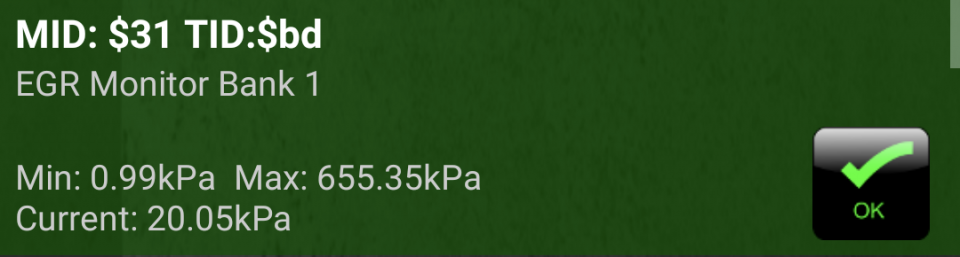

    If the car itself declares a problem below 1 kPa, maybe you set your personal trigger at "below 5 kPa" or "below 10" and declare an EGR weekend if you get there, and spend your time more enjoyably if you don't.

    I need to decide if I want to be a guinea pig for that. I cleaned the intake manifold ports but not the EGR valve or cooler yet. My EGR monitor test is 16 kPa. I feel less urgency to remove/clean the EGR valve and cooler, but I'll sure feel dumb if I wait too long and something bad happens.
