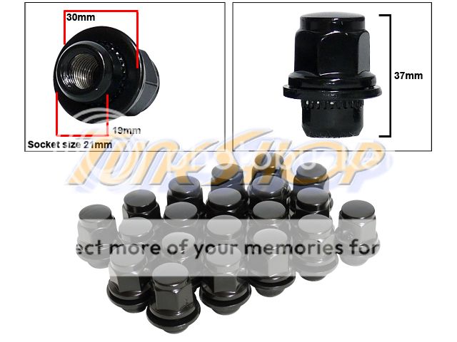

    Anyone know if the 2012 Stock lug nuts are 12 x 1.5? Im assuming they are the mag seat type with a washer right? I wanted to purchase new black lug nuts but don't have the car right now to check. Any feedback would be appreciated.

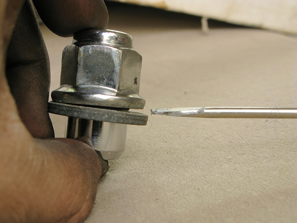

    My Gen3 has the washers.
    They look like this.

    Great. Thank you. I guess I ordered the right ones, Im replacing my stock ones with these. Thanks.

    I checked mine today and they do have washers that are attached to the nut.
