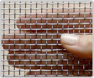

    I've used 1/4" galvanized wire metal screen to protect my radiators for years. I buy about a yard of it, trim it to fit with metal shears, and place it down in front of the rad with a friction-fit at the edges. Any stone smaller than a quarter inch wouldn't have the momentum to do much damage.
    I have over 175,000 miles on my Dodge Ram, a good portion of that on gravel roads, used in my consulting work, and I never had a problem with the radiator, having that screen protecting it. It also stops the moths and butterflies from embedding themselves in the rad.
