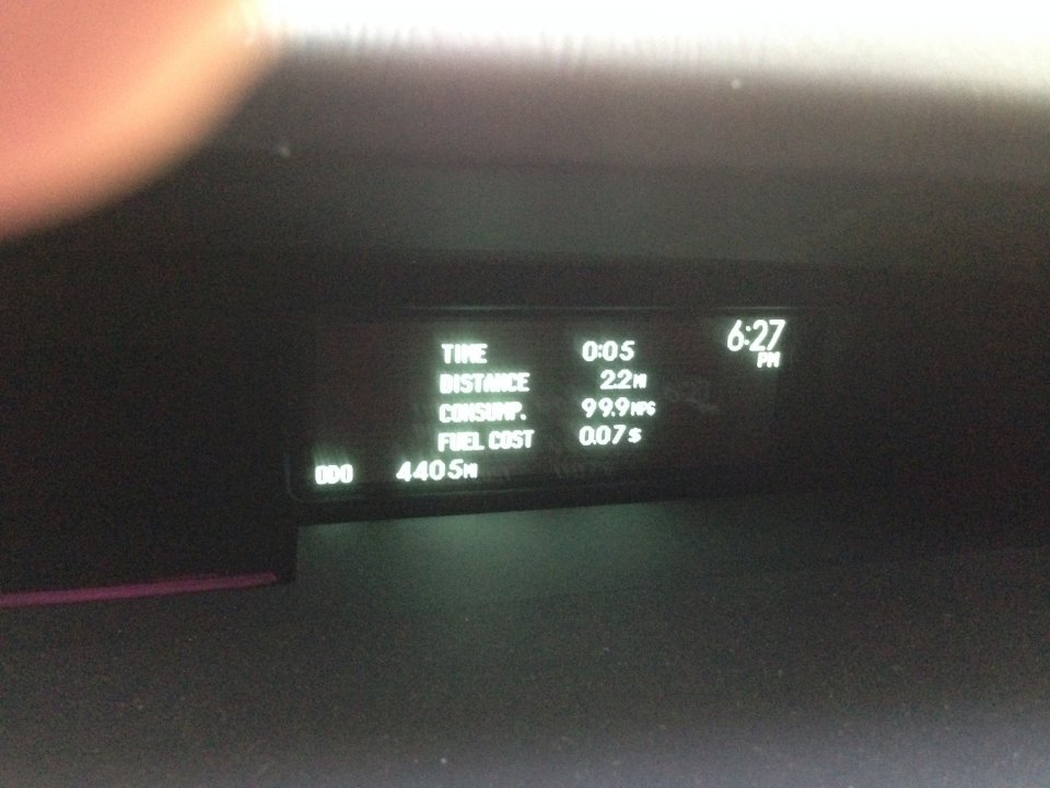

  20. Stratman
    Stratman Member
    Mar 19, 2014
    334
    74
    Lilburn Ga
