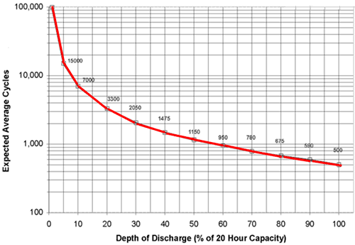

    This is the expected result.
    Strictly speaking, the lifespan for Lead-Acid batteries depends on the depth-of-discharge.
    Of course, this curve can be tweaked higher (more lifespan) by adjusting the design of the battery (giving up current output, as with the Optima-brand Prius replacement battery), but the fundamental shape stays the same.
    For your standard car-starter battery, the curve is like this:
    Of course, with a standard car, it's only using 5-10 percent of the battery to start the car until your engine/alternator comes on.
    I'd imagine with a Prius the lifespan is so short because people abuse the "Accessory" mode.
    On normal cars you can turn the key a little bit to get the radio, but most people probably just turn the car all the way on.
    On the Prius it's easy to hit the Power button without the brake pedal pressed and you get the radio. I bet a lot of people do this to listen to the radio without realizing it harms the battery.
    Combine radio with head lights on, and you can put a good 20-30% dent in the 300Wh lead-acid battery in 10 minutes. Maybe more with the fan and everything else.

    Hmm.... so the number of "cycles" shortens as the depth of discharge is deeper. So if we don't cycle the battery it should have infinite life? ;)
    Just saying that graph is not very useful for a Prius application.

    Heh, unfortunately it doesn't work that way. The 12V battery is being "cycled" every time the car is off.
    Also, all batteries have internal resistance, and a degree of self-discharge, so it's always draining.
    It's a fact of chemistry. As long as there's heat, chemical reactions occur. Short of storing the battery in the freezer, there's no way to avoid this.

    I suspect, and could probably prove, that if a Prius battery were not fully discharged during its life, the life of the battery would be very close to what it would be if not kept in service, but rather on a float charger. This is because in a Prius there really is no "cycle" as the battery is not discharged very much in use. The "starting pulse" is so short and of low enough current (50 A or so) it doesn't drain much energy out of the battery.
    In this case, the life is determined by the quality of construction (purity of materials, quality of mechanical arrangements), but mostly by the loss of water when under float charge over the years (I refilled Pearl's battery two years ago). It can be claimed the Prius battery operated on "float charge" when the car is on. Though the GIII system actually varies the charge voltage, so not so much for it.
