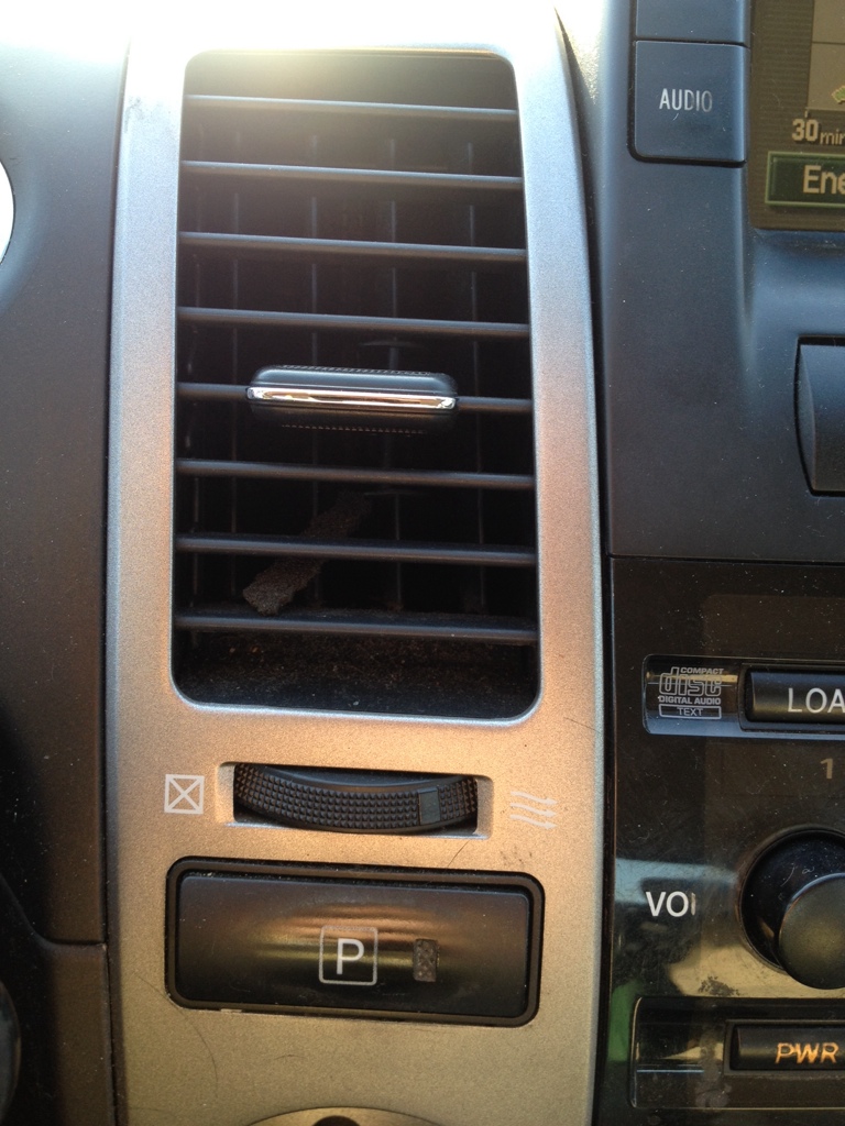

    That is a strange one. I was reading the Manual on the 2005 AC system last week. It's pretty cool the way it's engineered for efficiency. My wife was complaining she had no cold air and it turned out she didn't realize she had turned the vent off on her side? Well maybe I did it cleaning the car!

    that's it! how do you turn the vent off on the driver side only? shut down the grille in the middle, and the one on the left corner?

    Left is off, right is open

    thanks. and the one left of the steering wheel, same thing?

    All four of them.

    wow, that must have been some cleaning job.unfortunately, the o/p says his daughters vent is blowing hot air.:(
