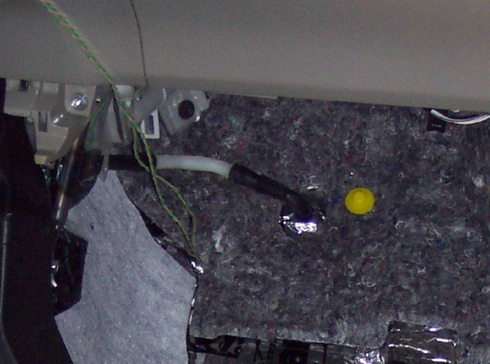

    Getting access to the drain tube is fairly easy. Find the upper left edge of the passenger carpet in the foot well. Then carefully peal it towards you and within a few inches, you will see the tube. I'd say disconnect the lower black rubber part from the white plastic elbow and that is where I would suggest "injecting" the Kool-it.

    I think you will find the "in car" method much easier than jacking up the car and searching for the outlet of the drain tube. Try my suggestion of pulling back on that piece of carpet and you will see the white tube with back rubber connections on the top and bottom of it. Gently pull off the lower rubber tube from the white tube and there's where you inject the cleaner. The OD (outside diameter) of the white tube is about 5/8 inch or metric equivalent. If you opt out of a "rinse", all you would need to do is inject the foam in the white drain tube, block it for the specified time (I think it's 20 to 30 minutes), and then reconnect the drain tube to the black rubber tube and let the gunk flow out of the bottom of the car. Someone suggested having a rag handy to catch any outflow as you reconnect the drain tube to the black tube. Then just press the carpet back into position. You could put a plastic catch tub under the car so the gunk with dead mold doesn't get on your driveway. I've read the output of the flush is a purple-green color. Yuck! Think of all that mold living in your HVAC coils!

    If you normally see condensation dripping from the bottom of the car after it has stopped, this could mean a blockage. After running your car with the AC on during humid times, park in the driveway and get a rag ready. Pull back the carpet and disconnect the white elbow from lower rubber connection and if water starts running out, you could have a blockage somewhere (the rag is to absorb the condensation if it starts running). If there's no condensation, it could be blocked in the coil box near the drain opening. I'm not sure if they make extra long pipe-cleaners, but running one up towards the coil box might clear a blockage. My guess is that it would be blocked after the floorboard under the car.
    Sometimes when it's really dry here, there is no condensation but I'm not sure about where you live.

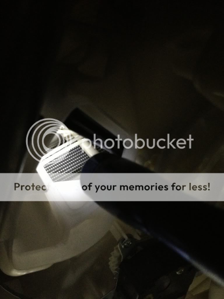

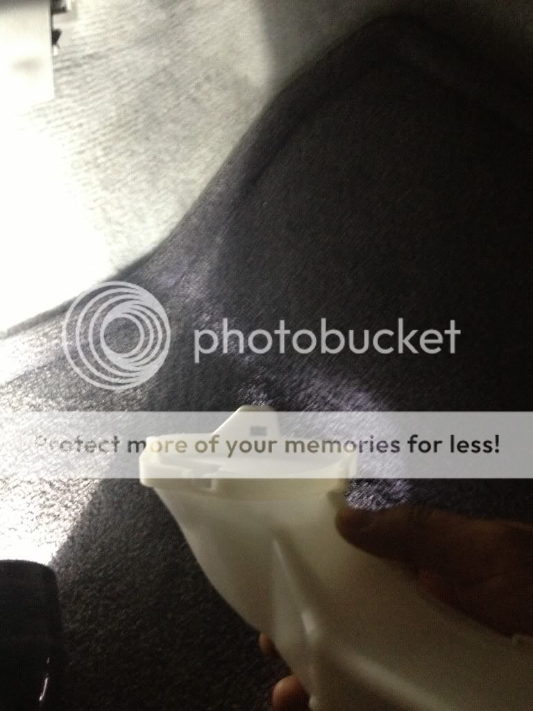

    Here's what I found. Phoenixgreg is mostly right in regards to the footwell heat vent being connected to the a/c evaporator coil. The heat vent is actually in-between the two cores.
    I pulled off the footwell heat vent piece (and broke one of the tabs on that piece, so be careful), and here is what I saw:
    This is the piece that has to come off, note the part that I broke. I'm not sure if this is avoidable...it may take a lot of care to take off this piece without breaking one of the tabs. However, even with one tab, the piece is still 70% secure...
    Anyway, I'm guessing that the top core that you see (silver color one, not the black one) is the heater core. The darker color one on the lower level is probably the evaporator core?
    If so, then there's no need to drill any holes - just pull off this piece and spray the product in. The core is about 4-6" from the entrance, so you'll need a longer hose of some sort to reach it.
    Mine looks okay (plus the odor has been gone again for a while, ever since i started using fresh air mode only) so I'm probably not going to spray any in there. I do have the BG frigi-clean kit if anyone wants to buy it....since I bought it and won't be using it for a while, if at all.

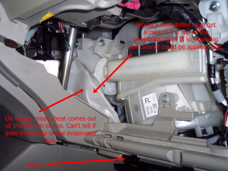

    Thanks. Now that The Critic has removed the plastic vent tube, we can see the heater and evaporator coils as they are stacked in the chamber box.
    @ The Critic,
    Thank you for your courage to remove that plastic vent tube so we can have a look at the evap and heater coils. Now that I see how the tabs look, maybe there's a way to "squeeze" the top of the assembly in such a way that it can be removed without breaking a tab.
