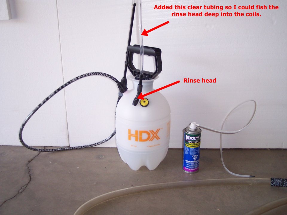

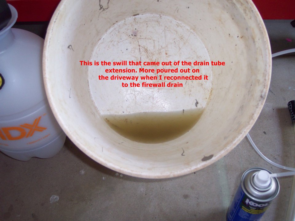

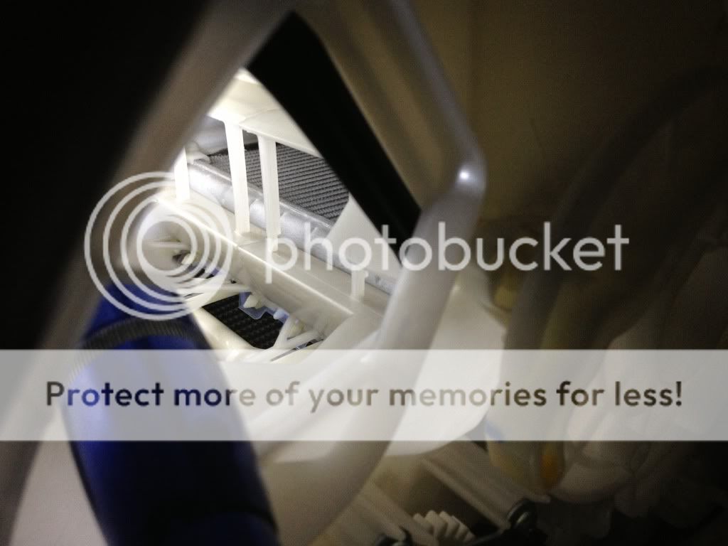

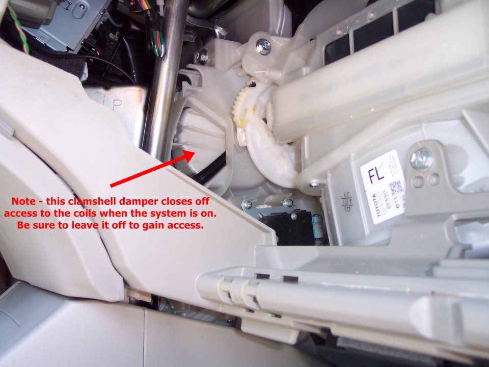

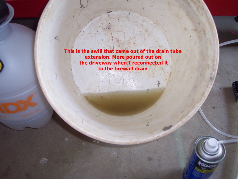

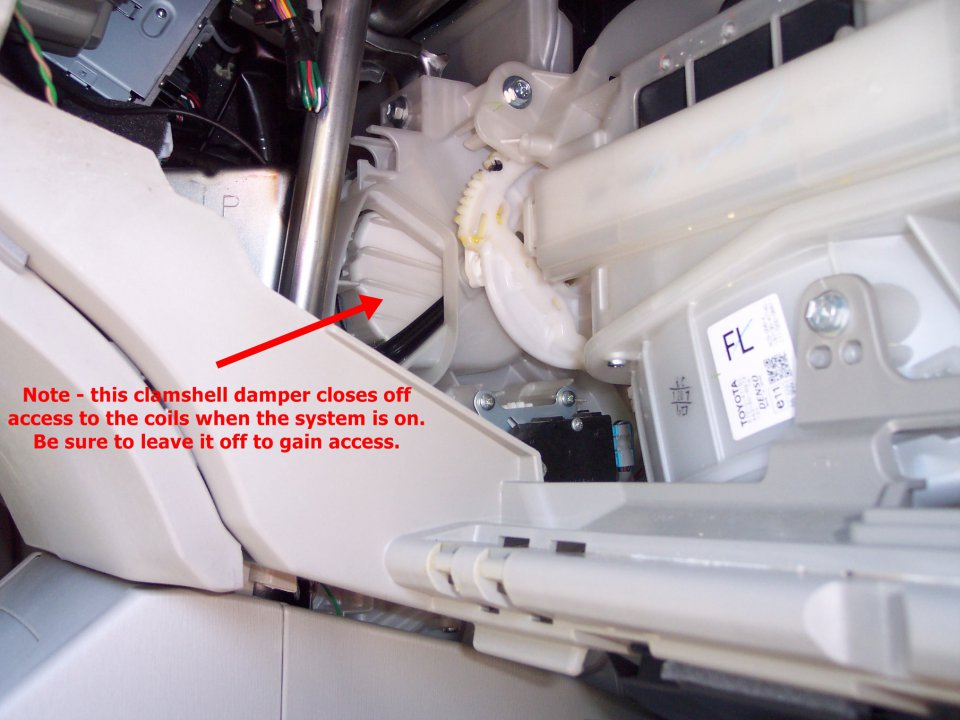

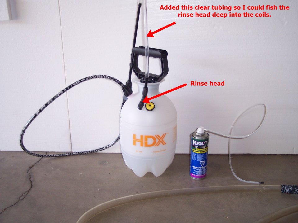

    I, on the other hand, did the Kool-It treatment to my coils and thanks again to The Critic, was able to gain access to the topsides of both the evap coils and the heater coils. I sprayed foam from Kool-it on top of each coil thru the passenger heater vent, which comes off if you gently pry from behind the tubular pillar and then rotate it towards the firewall. After foaming the tops of the coils, I then went up the drain tube and injected the rest of the can until it was empty. I then reconnected the drain tube and pinched off the top rubber segment so the product would stay in the air chamber box and waited 15 minutes. After that, I removed the pinch from the drain tube and gunk drained into a pan below the car - yuck - it was brownish green! (See pictures). Then I had repurposed a yard sprayer so the head could be fished into the chamber and moved around above each coil. I applied rinse water and flushed out any remaining mold that didn't come out with the Kool-It. Again, more brown gunk!
    My take-away from this maintenance is that the coils should probably be cleansed perhaps yearly to prevent mold buildup. Now I have the experience and tools to do the job properly. Oh yes, there's a nice clean scent from the vents again. Here are some pictures:
    Evap coil cleaning 001.JPG Evap coil cleaning 002.JPG Evap coil cleaning 003.JPG

    Im going to do this on Sunday. Do you guys have any last minute recommendations or pointers? I bought the Kool it cleaner and a sprayer. I had a look at the vent you guys pulled out from behind the glove compartment. I couldnt figure out how to get it loose. I dont want to break the thing but while Im at it I want to do a very good job cleaning everything out. Thanks guys.

    Use a very small thin-bladed screwdriver and with it, find the plastic tab on the side of the plastic vent tube near the shiny metal vertical support member that is towards the console. Slowly press downwards until the screwdriver catches between the tab and evaporator chamber and when you feel it freed from the evaporator chamber, then rotate it towards the firewall and it will release without damage. To re-install it, hook the tab into the chamber on the firewall side first and then rotate it back towards you until it snaps back into place.

    Hello phoenixgreg, much thanks to you and the critic for the instructions to help with the odor. I too do have the odor and I drove my car onto the ramps I purchased a while back to work on my cars. Found out that there's so much plastic shielding to maintain smooth airflow under the car and I could not find the drain tube. Do you know where the drain plug is located under the car?
    I really like the fact that you spray the kool-it cleaner from inside the car. That really helps make it much more simpler. I have a quick question. In the 3rd picture, you mentioned that the clam shell closes off access when the system is on. Can you explain further? What system, the AC being on and the fan being on or the recirculation or recycle air when the car is powered off? It has been pretty cool here in FL so I have not run my AC, but I read that there is a possibility that the tube may be clogged too if no condensation is dripping under the car when the AC is on and the car has stopped.

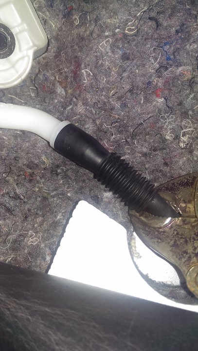

    I would suggest accessing the drain tube from inside by pulling away the upper left corner of the passenger's carpet. You will see the drain tube lined in a bit of styrofoam. It has a PVC joint where you can separate it to inject the Kool-It upwards so it gets into lower evap chamber. You should blow into the lower end of drain tube (PVC) to be sure it's not clogged. Air should freely flow thru it, or try to blow the clog out (unlikely). BTW, don't do this with the car up on ramps...you want the evap box level so it will drain properly.
    Leave the car OFF and you won't see the "clamshell door" getting in the way of the upper and lower coils as per my picture. If you can inject some Kool-It into that opening too, you will get the upper section of the coils. Don't forget to "pinch-clamp" the upper rubber drain tube in the carpet area after injecting the Kool-It so the gunk doesn't get in your car. When the Kool-It has soaked for about 10 minutes, re-connect the drain tube in the carpet area with a catch-pan under the car and "un-pinch" the rubber drain tube. You will quickly discover where the drain tube exits on the bottom! Again, if you can do a final gentle yard-sprayer rinse thru the upper opening, you will get any remaining gunk out of the coils and lower evap box. Good luck.

    I did what was suggested, peel the passenger carpet top left back, removed the backing under the glove box (take care to disconnect the footwell led light that is attached, not sure if it is only on a P5 though), pulled out the plastic tube from the lower rubber tube, inserted the koolit hose. I could only insert it about 8"-9". I'd thought it would have gone the entire koolit tubing. I discharged the koolit contents, pinched off the rubber tube to prevent any back leaks, let it stay in the system for 20 mins, reconnected and turned on the fan for 10 minutes.
    Strangely, I still have a slight odor. I'm wondering whether I need to pullout the glovebox as in post #42, 3rd pic to expose the opening covered by the clamshell like damper and discharge the koolit. Phoenixgreg, your car is a 2010, I'm wondering if it's different in yours since mine is a 2013!! I have an extra can just in case, I'm wondering if I should repeat. Then again, not much gunk should have built up since the car is a 2013 with 24k miles. Thoughts anyone?

    prinut, did you get allot of greenish brown gunk in your drain pan? My post shows taking off the glovebox and then the passenger's heat-vent tube to see inside the evap box. If you decide to revisit your evap box, be sure to follow the instructions on how to remove the passenger heat vent tube behind the glove box so as to not break it. You will need a high-intensity mag-light to see in there once the vent tube is removed. What I did was to discharge some of the Kool-It over the top of the coil too and on the underside of the heater coil (they are sandwiched with a bit of air-space in the evap/heater box). Then when the Kool-It has done its job, I also did a gentle rinse of the box using a small sprayer into the access where the vent tube attaches to get the coils completely cleansed:
