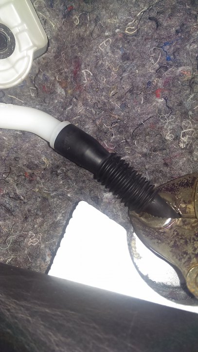

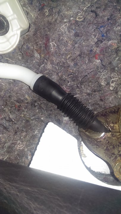

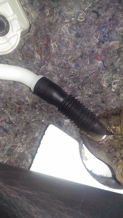

    Prinut, what your final result of the kool-it treatment? I am planning to do the same thing by injecting the foam directly into the drain tube indoor without taking the car apart. Did spraying the coil directly improve your situation?
    Thanks .
  3. highroller
    highroller Junior Member
    Mar 4, 2014
    78
    In your opinion, is injecting the foam directly from the drain tube indoor enough to deal with the problem? Or is it necessary to take the car apart to reach the coil? I tried before to reach the coil before i saw this thread, and i had a hard time to do it, and i don't plan to do it again. Is there any household product that can substitute this foam product? I don't see why not except that i need the long tube from the can .
  4. phoenixgreg
    phoenixgreg Senior member
    Apr 7, 2010
    1,157
    289
    Phoenix
