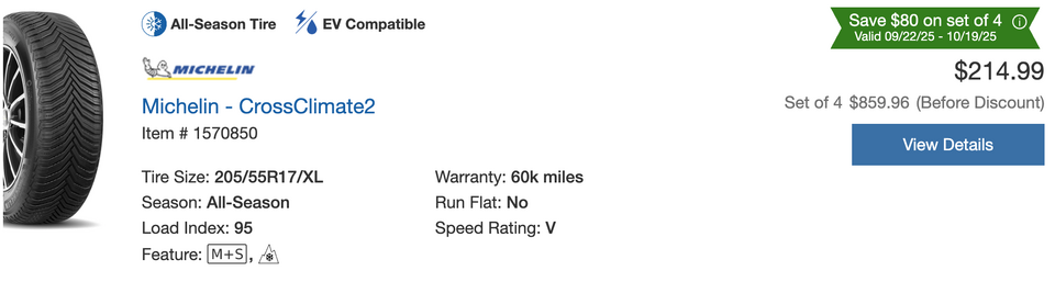

    This is what I have. Today is Costco's last day for $80 off a set of 4. Looks like Tirerack.com has similar offer with reward card through December 9, 2025.
    Happy with them. Got them back in 2023.

    Nice, but that is in a different size.

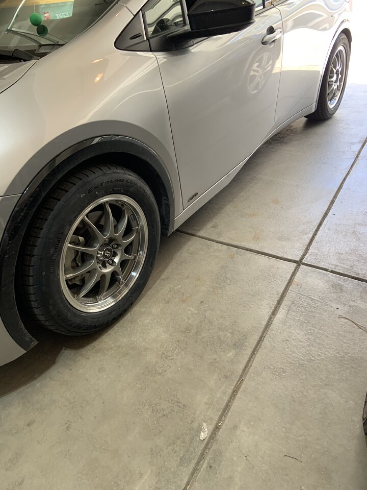

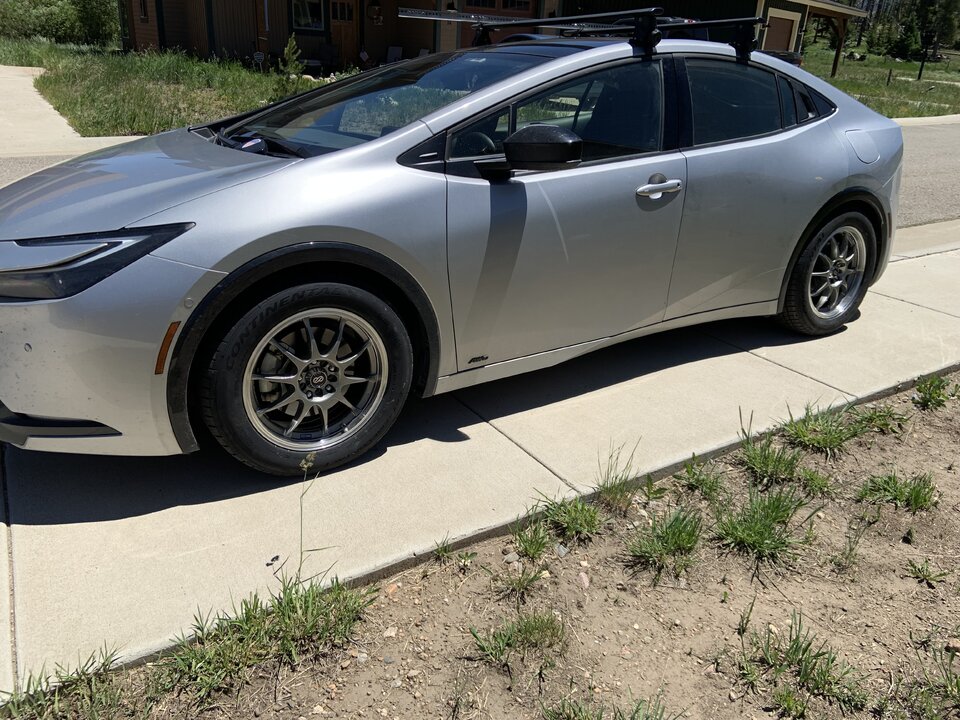

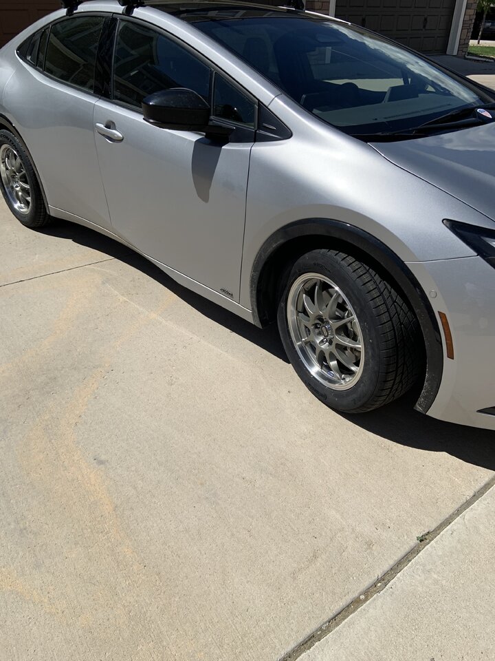

  15. Blackat
    Blackat Active Member
    Sep 29, 2023
    488
    356
    Colorado
    2023 Prius
    Limited AWD-e
    I have 225/55/17.
    Gokhan likes this.

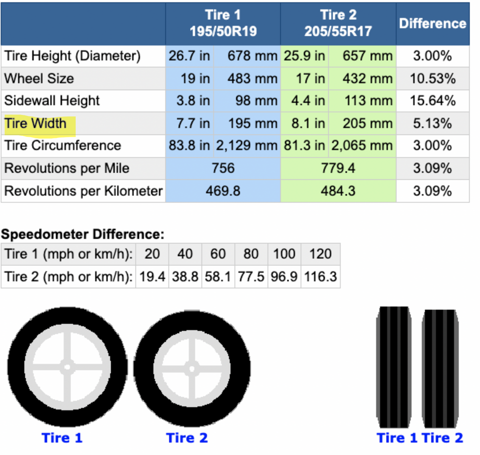

    Another question would be whether you can change the odometer ratio in the car's brain?
    I wonder if the tire height of the oem 19's are the same as the oem 17's, or did Toyota tweak the brain a little.
    I thought @Mendel Leisk said that 215/55/17's are very close in diameter to the oem 19's, but where does that leave the stock 17's.
    Ordinarily, I would care, but since mpgs are important with this car....
    Have to do some research myself.
