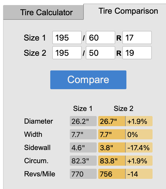

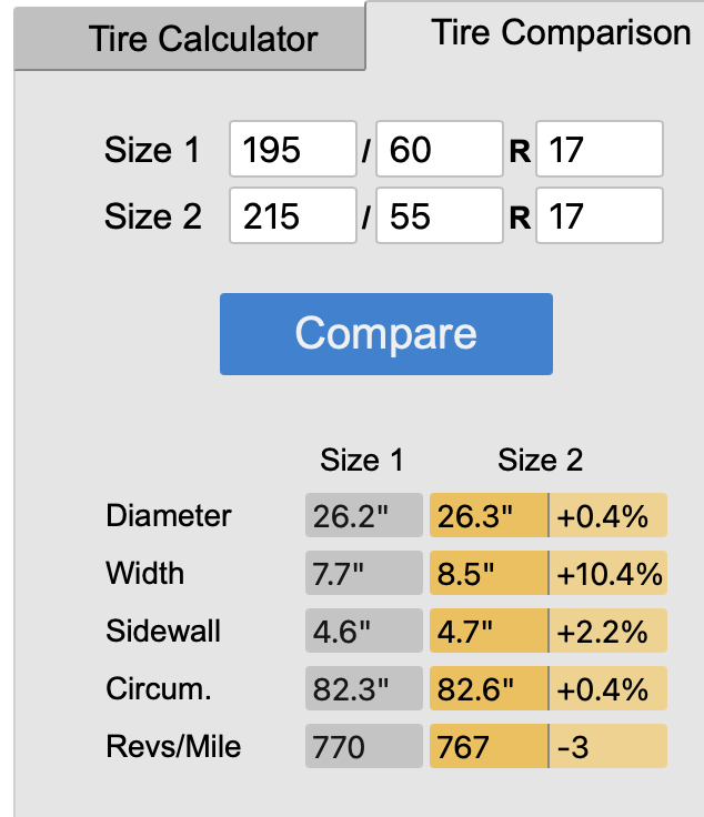

    Per Tire Size Calculator:
    The 215/55/R17 are closer in diameter to oem 195/60/R17 than the oem195/50/R19's are.

    Yeah owners manual pdf (you MUST have downloaded by now?), tire specs are in there, and enter into online tire comparison calculator.
    IIRC with 5th gen, the stock 17’s are about 1/2” smaller diameter than 19”. With the 15” and 17” on gen 3 and 4, it was other way around, and 1/4” diff at most.
