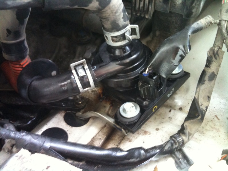

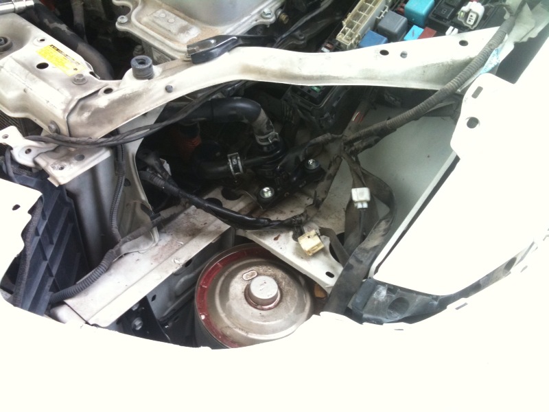

    Here is its location, mounted on the metal just in front of and below the fuse box, behind the left headlight. (The headlight is removed in this photo, but you don't need to do that to unplug it).
    And here is a close up of where the electrical connector is located.

    Hi I just want to say thank you for all the comments that contribute to this site. I totally just saved over 800 dollars by finding you. Being that I am a student/single parent that was big. I bought the inverter water pump removed the light and installed it by removing 3 screws! First of all my 8 tow trucks later being that my car had been blocked by a car infront which made it difficult for it to be towed 10hrs later. Web searching I stubbles upon your question and feed back. I went to auto zone replaced the AM2 fuse and it burned quickly. I then replaced it again and the same thing happened. After being towed to a hybrid fix they were going to fix the problem for 390 over 1000 at the dealer. The young man got my car running by pulling the plug n this picture and reinstalling the 15a fuse for the AM2. He adivines me that i could drive my car home for 7 miles as long as I didn’t go fast and stayed on the right lane. #blessed #grateful #am2fuse #saint and I didn’t have enough funds to cover it and found the part at Oriellie’s since since I couldn’t wait 7 days for an online shipping because I needed my car to get around ASAP they had it instock for 150. I seen a diy and proceeded to change in 2 hrs later my car was back running. Now i still have the problem where my car struggles past 50mph and the yellow light with a squiggle comes on while I try to accelate. Well hope anyone that is having trouble can find this helpful. As putting the car on neutral and getting back running is essential for me. Thanks everyone
