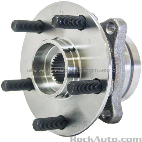

    Hub (photo from Rock Auto). RA has various manufacturer front and rear Gen 2 hubs available from $30 to $180

    I just don't understand why you want to make your life complicated. Just replace the HUB. Not the knuckle, not the bearing, the HUB. Quick and easy and there's no chance of damaging the bearing. For what you paid for bearings and help, you could have 2 new Timken hubs that will last 300k miles.

    Yes I am replacing the bearing and Hub, as they come together as showed in the picture you posted. The issue I had is the bearing is out but the hub is still stuck with the knuckle. Or I misunderstood what you meant?
