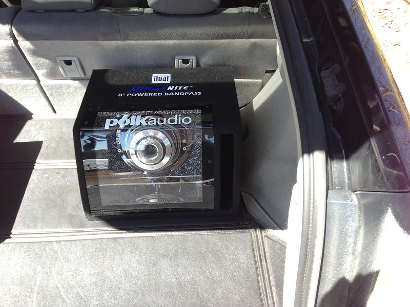

    My subwoofer has a built in amp, so if you don’t, you’ll just need to attach the amp to the speaker at any point.

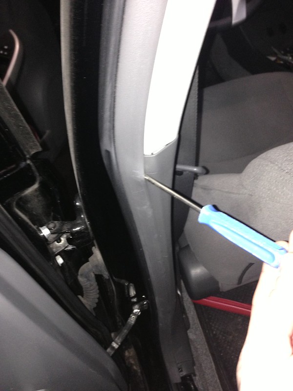

    2. Remove panels around door from prius rear, and the battery cover in the back left of the car
    You can pull right at this friction clips location ^, and once that one pops off, pull the rest with your hand, along with the bottom so it looks like this:

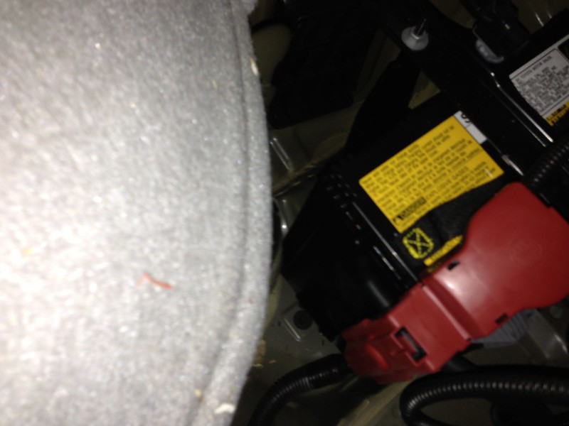

    3. With the battery, lift up on the red tab shown below, loosen the screw with the socket wrench, and get your power wire underneath the screw and tighten. You don’t have to disconnect anything on the battery.

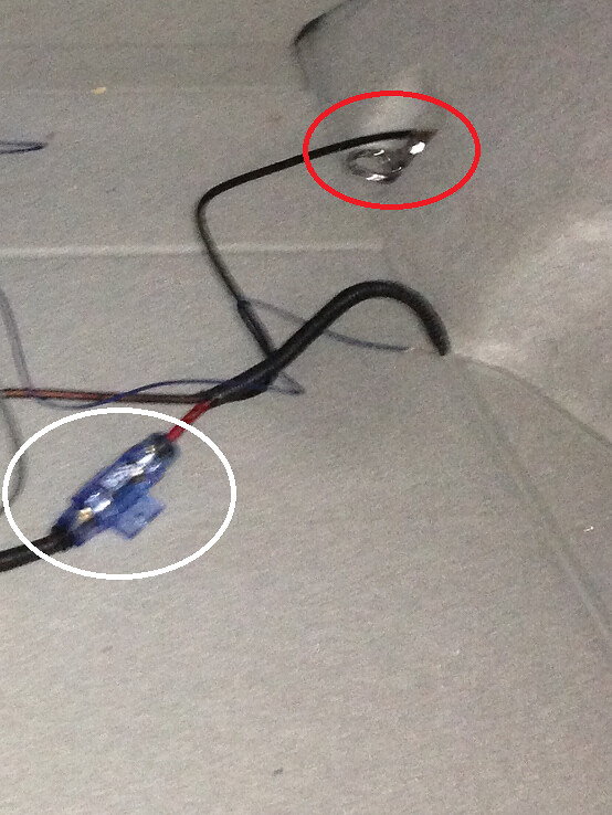

    4. Take that wire, and connect the fuse in the middle of the power wire, anywhere less than 3 feet from the battery connection. (White circle below!)
    5. Connect the power wire to your amps power connection.

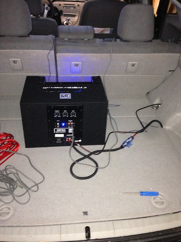

    6. Take your ground wire, run it from the Ground on the amp, to a ground location in the prius. I used the screw in the back of the prius (Red circle in picture), because I don’t use them for anything , (Do not let the ground wire touch your wire from the battery! Or the fuse will blow)
    7. (optional, recommended) Take a small piece of speaker wire (few inches long) and run the wire from the amps remote turn on, to the amps power screw. The amp should power on!! If it doesn’t, check your connections, somethings wrong.
    A mess right now.. clean it up after you’re done..

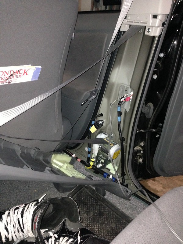

    8. Amp off, connect your speaker wire to the amp for the left/right, and then move yourself up to the back seat where the rear panels are off.

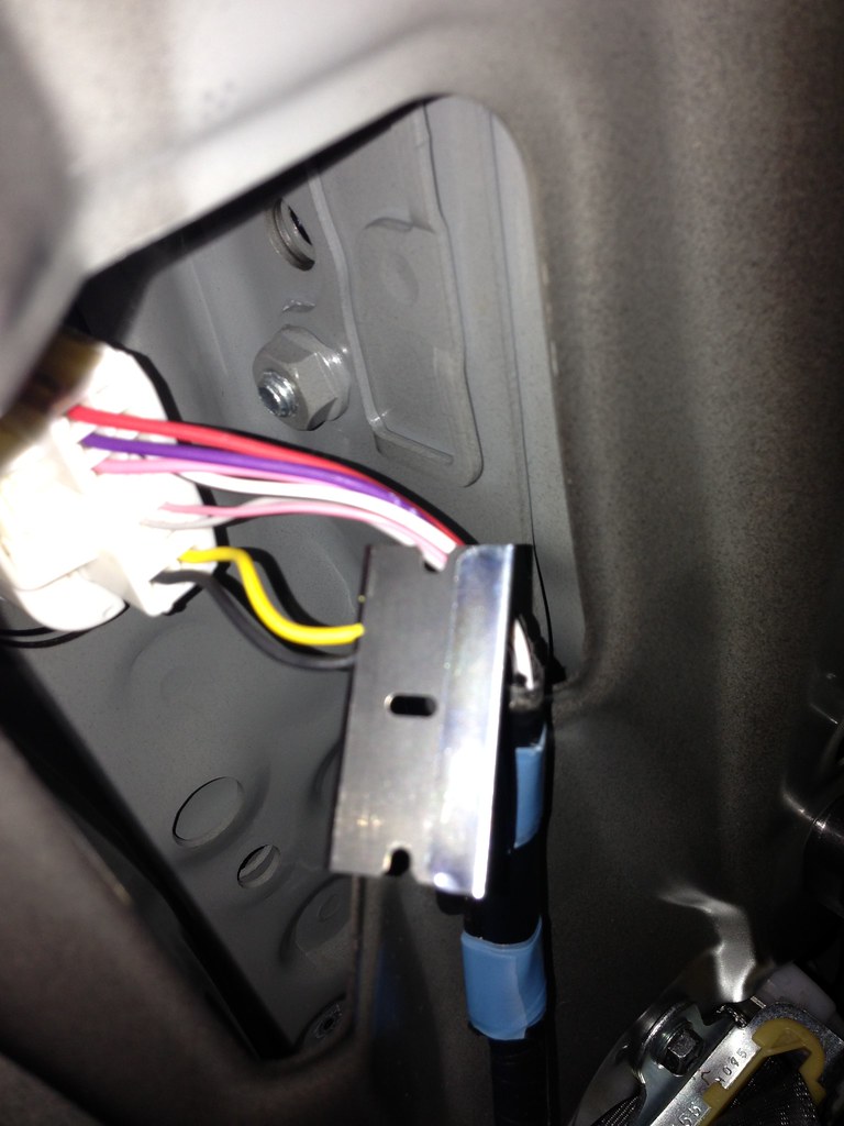

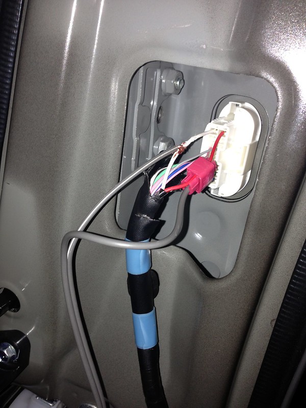

    9 (right). For the right side, you're looking for the red and white wire at the top of the connection to the door. Then either use your wire tap-in (not recommended by me) (shown below with the red wire), use a razor blade to make a connection without a wire tap-in. (shown below with the white wire)
    10. (optional) Power up your amp and test it with music, some bass should work.

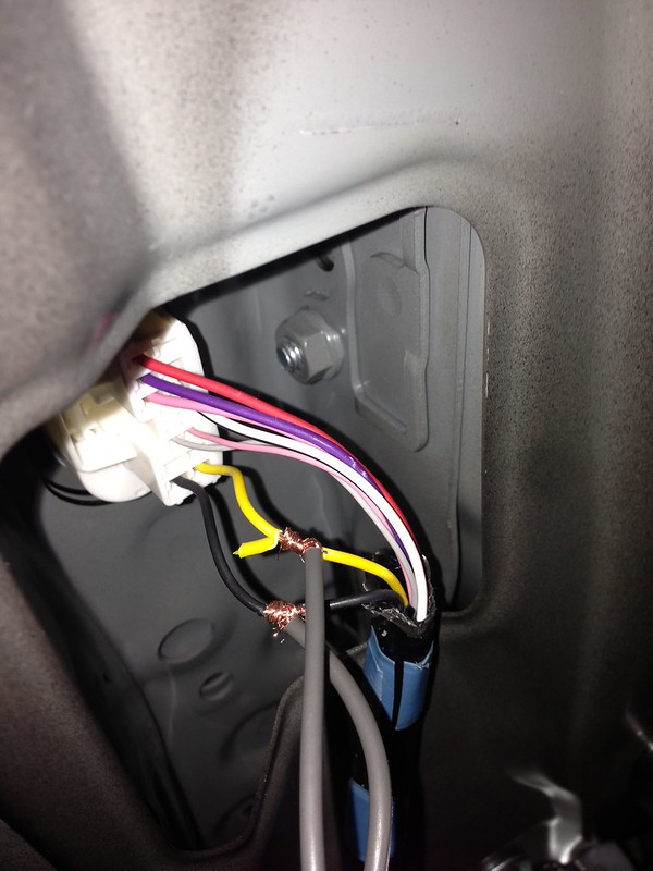

    11 (left). The left will have a black and yellow wire, on the bottom of the connection to the door. Use a razor blade like seen below to carefully cut a bare spot of wire again.
    12. Connect your wires, and use electrical tape to cover these up well.
    13. (optional, recommended) Power and Test Your speaker, make sure you hear all bass sounds. If not working, somethings wrong with the connections. try switching your speaker wires on the amp around.

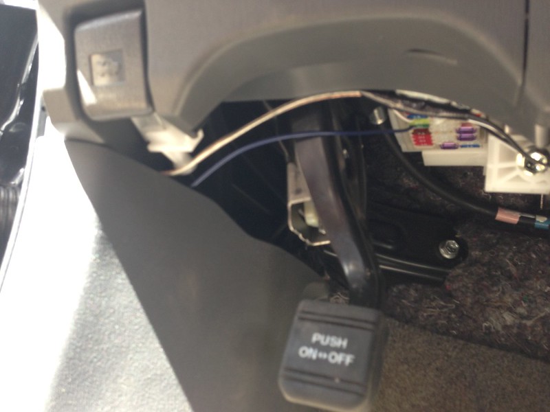

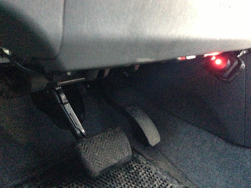

    14. Before placing panels back on the car, run the remote turn on wire up the right side of the car, under all the panels, all the way to under the steering wheel. I found this the easiest to use, unlike many suggesting the centre console, AND this will have 100% hidden wires, which you couldn’t get with the centre console.
    --Ignore how theres two wires, one is used for LEDs

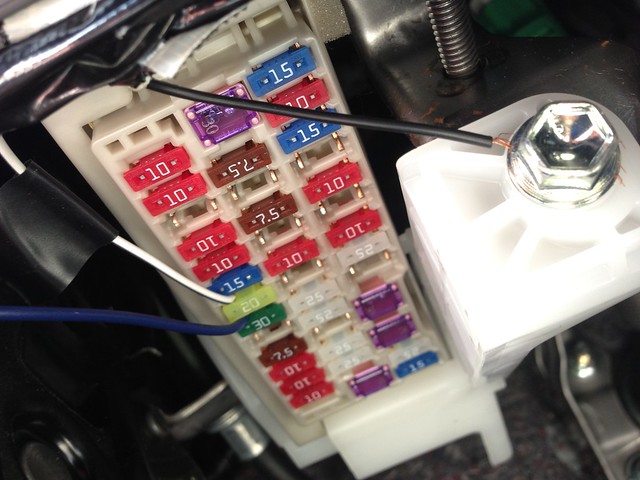

    15. Connect it to a fuse that turns on with the car (just put it under the fuse and pop the fuse back in, or buy one of those special fuses with an outside connection, if you must.
    The yellow 20 works out well, used for the rear windshield wipe.
    16. Test, turn on your car and make sure the amp is on with it, and off when the car is off!

    Good job on the write up, I like that trick with the remote wire wrapped around the fuse. I would watch those speaker connections though, a bit of solder on them is worth rolls of electrical tape

    I wouldn't do the razor blade splice that you did there. It's not very secure, and if it comes lose it can easily short out the speaker amp in the radio. It would be better to use T-taps, as they are insulated and more secure.

    I've attached what a T-Tap looks like. The ones you were using are a pain in the butt to work with and disconnect if needed.

    For anyone interested in tapping into an existing fuse, please don't wrap the wire around a fuse blade and just jam it in there. Take the time to do it right. It's not even expensive.
