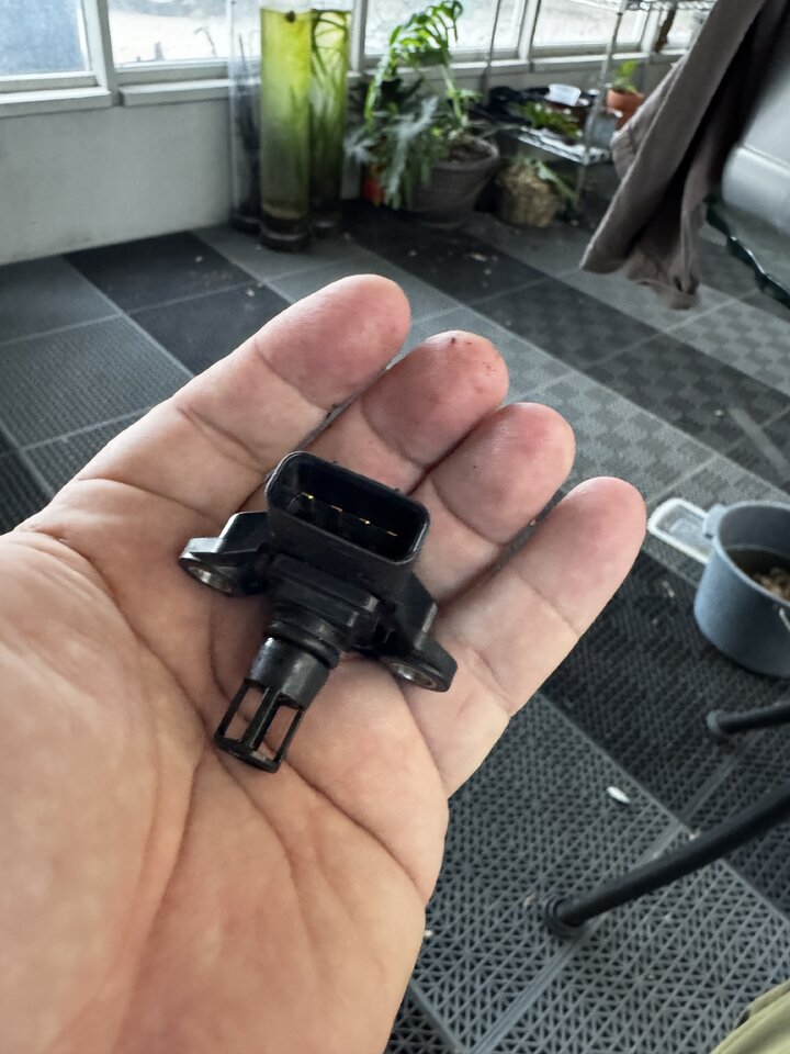

    So, new to me V w/ ~153k miles. Since I’m furloughed right now, tackling cleaning the EGR & manifold.
    I missed taking off the exhaust manifold MAP sensor (oops! I was still kinda numb after the hassles of removing the EGR cooler ) and it was submerged in degreaser solution for a few hours. Should I replace it??

    Do you have a scan tool that can show the MAP reading?
    Does it match your local weather station's barometer reading when the engine is off, and go down to something near 4 psi or 27-30 kPa when the engine is idling?
    If so, it'd seem to be still doing its job.

    I’ll fire up my old version of techstream, & see if can check it. Thanks

    I think I used the wrong units above in #2: a sensible MAP reading at idle (with no EGR) is around 4 when shown in psi, but that's more like 27 to 30 kPa.
