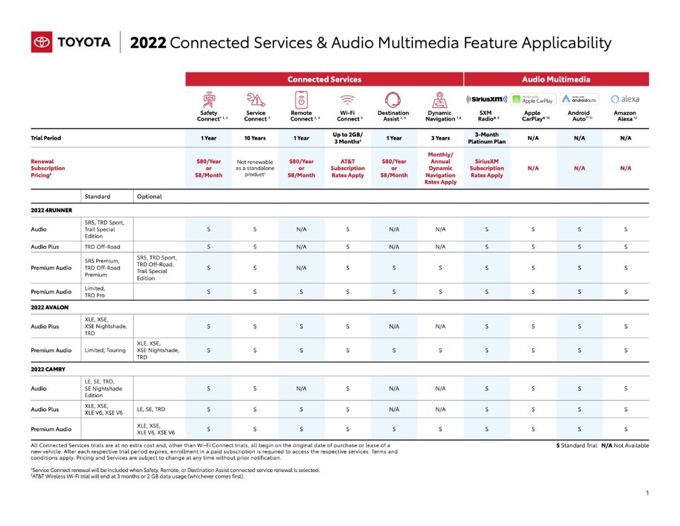

  18. LRO
    LRO Member
    Jul 5, 2025
    97
    98
    United States
    2024 Prius Prime
    XSE Premium
    Looks to me as if the 2022 Camry SE would have had to been equipped with at a minimum the optional Audio Plus package in order to get the "Remote Connect" capabilities. Seems to reason any extra electronics/software to make remote start work (even with no subscription and using just the key fob) comes only with upgraded audio systems.
