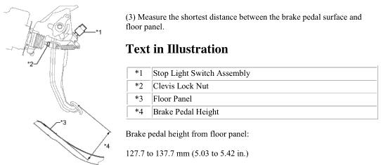

    It probably shouldn't be as common as it is: if I had caught you in time, I would have suggested a very careful recheck that you got the new actuator fully seated down on the firewall, nothing stuck behind it (no old gasket left behind or the like). If it's not fully down on the firewall, the pushrod won't extend the right distance into the cabin, the pedal will be too low, and won't contact the switch. Probably also the stroke sensor reading will be wonky.
    Once the actuator really is for sure seated right down on the firewall, it is still possible the pedal is too high or too low: that's adjusted by turning the threaded clevis on the end of the pushrod (after loosening the lock nut).
    (Note the reference distance is from the bare floor sheet metal, after folding the carpet/pad back out of the way.)
    If the switch was working right when the pedal height was correctly adjusted before, then when you've done the work and you get the pedal height correct again, the switch will still work right. So times when the problem is really the switch adjustment should be very rare. When the problem is something else, adjusting the switch is a "now you have two problems" kind of fix.
    Using your scan tool, you can also view the live data list for the skid ECU to see the pedal stroke sensor reading. It ought to be one volt (allowable 0.8 to 1.2) in gen 3 when the pedal is not pressed at all. If it is out of that range, there is a stroke sensor adjustment, but again, if it was ok before the work was done, then you should make sure of the pedal height adjustment first, before going and tweaking the sensor.
    Note to self: if my car ever needs this job, I'll probably just note the stroke sensor reading before I start, then adjust the pedal height later to get the same reading, and not fuss with folding the carpet back to measure from the pedal to the bare floor.
