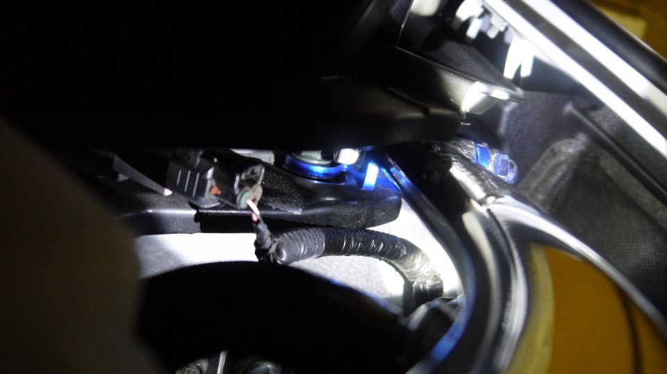

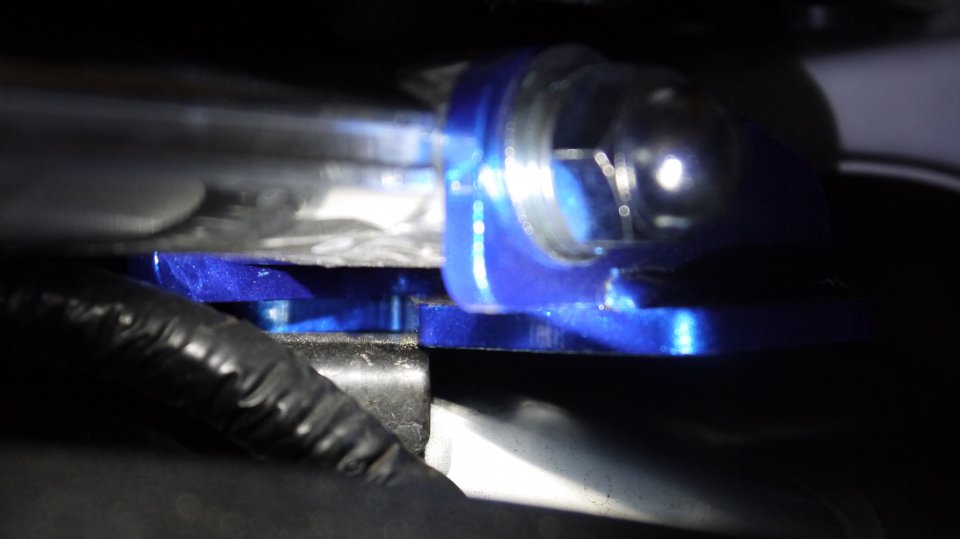

    I just got mine today, this one from Juicehybrid.com, I ordered one before from Autoplicity.com waited 1 month and a half, they got me the RHD version, I have to return it. This time I think I got a new version from Cusco, I don't have to trim or cut anything like "hbpb" mention. I used the supply super thick washer to raise the height compensate the mounting bracket, it clear the brake fluid reservoir bracket, I believe Cusco might have change the mounting bracket. I started around 9:45 PM and finished it 11:30 PM, I took my time and when reassemble I stripped one of the wiper motor mount bolt, (@#$%^&
    Test drive it doing 85 mph, no need to use 2 hands to hold on the steering wheel, just the palm rest on the top of the steering wheel, it made a noticeable improvement, highly recommend.

    Here I am enclosed the photos I just took, this may clear any confusion member may have! P1000548.JPG P1000549.JPG

    It's amazing that a simple washer beneath the bracket was all that was needed to address the fitment issue...

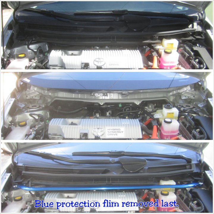

    So that's the blue protection film which you remove to reveal the aluminum bar? Cusco should've powdercoated the whole thing in Cusco blue. Looks better that way.

  11. NoMoreNow
    NoMoreNow Member
    May 13, 2013
    167
    102
    SF Bay Area
    I total agreed with you, the blue looks way better that's why I took picture of it. Only part was blue metallic powercoated was the brackets.

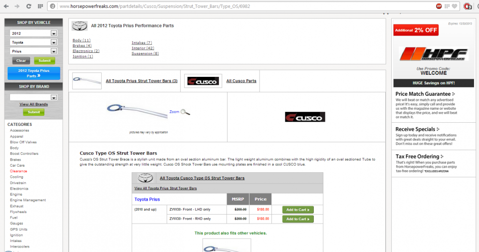

    Here is the
    linky Cusco Type OS Strut Tower Bars | HorsepowerFreaks
    For $180 shipped (dropship) and no tax to Calif.,
    please call and ask for:
    Sean C Mcgill
    ext: x226
    Just tell NoMoreNow from PriusChat.com referral you. Otherwise there is $16 s&h.
    Juicedhybrid.com was my 1st option, and Per Ginnie that I have to wait at least 30days and no discounts will be given for the wait, I told her please cancel my order per request (not going to wait).
    After few searches, horsepowerfreaks.com had the best price and is instock.
    btw, just fyi: horsepowerfreaks.com are located Gilbert, AZ not in Calif, The people you called in Calif was
    "Authorized HorsepowerFreaks Dealers".
