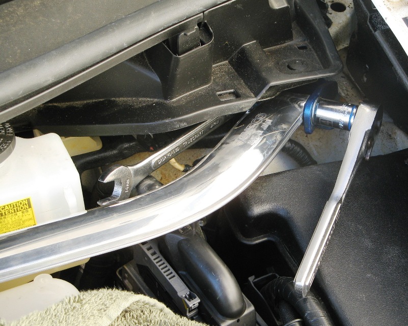

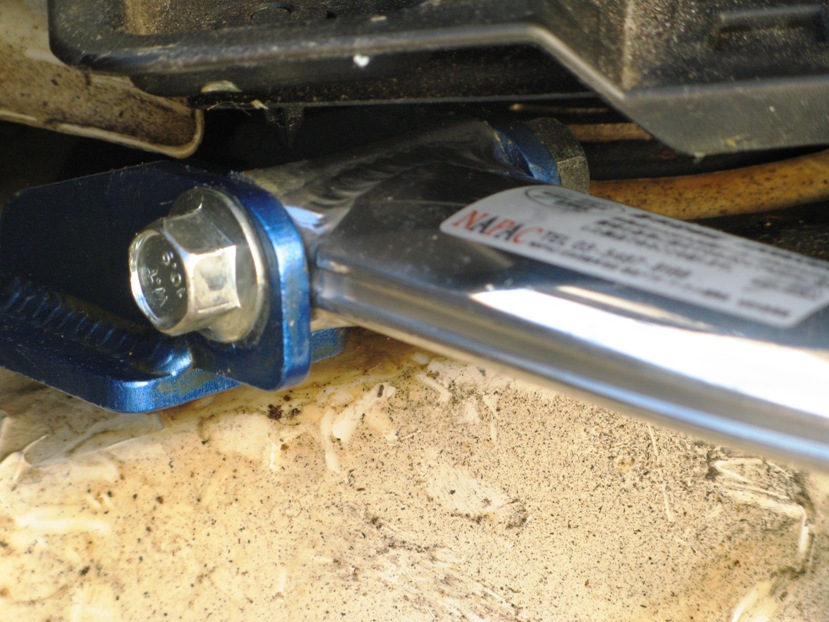

    I went out today and improved the bolts that hold the bar to the brackets
    The ones supplied are cheap 8.8 grade socket headed caps screws in coarse M10x1.5 thread that you'd NEVER see as OEM on any Toyota. They use two flat, one split lock washer and some really cheesy acorn nuts with 17mm hexes. You can't get a box wrench and can hardly get an open end wrench in the area where the nuts need to go.
    I got the correct length J.I.S. (Japan Industrial Standard) flange bolts with the 14mm small heads on them and the locking flange nuts, also with 14mm hex flats. Toyota uses 8.8 grade for the chassis parts. I got superior 10.9 grade bolts and nuts.
    The hex socket driver takes too much room to conveniently remove with a ratchet. The 14mm socket with a 3/8 inch ratchet makes the bar a breeze to remove and replace.

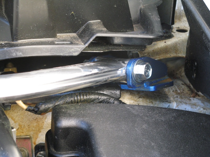

    Here are a few...more to come...

    It's not as easy as you think.
    You can't just go to Home Depot, Lowe's or your local hardware store and just pick up these specialty fasteners.
    Grainger, Fastenal or MSC don't stock them and probably can't get them.
    I am in a concentrated automobile engineering and manufacturing area. BMW AG USA, Michelin Tire and ZF Transmissions, Freidrichshafen GmbH are here.
    I was lucky enough to find a local automobile "prototype" supplier who had a New Old Stock package on the shelf of the correct fastener. The guy said that it had been gathering dust on the shelf for closed to 10 years. And, he refused to sell just the couple that I needed. I had to but the whole package.
    I particularly like the 14mm hex head flange bolts and nuts, because a 14mm wrench is widely used on most all Japanese cars. 17mm hex heads that CUSCO supplies, while common in European cars, is seldom used in Japanese and Korean manufactured ones. Also, I see minimal use of 8mm hex sockets on them.
    I'm looking to source more of these fasteners.
    CUSCO evidently, for whatever reason that is unknown to me, probably had cost and availability problems for the 10.9 J.I.S. bolts in the OEM M10x1.25 thread in the long length necessary or the quantity of minimum purchase required was too cost prohibitive. They evidently chose hardware store quality and type fasteners.

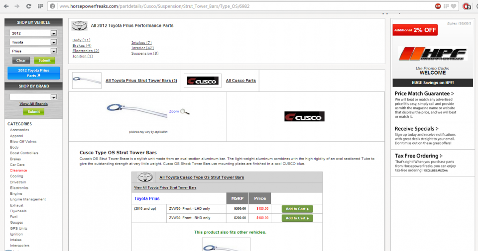

    Is Juicedhybrid the only site with the correct new version product code at $215.00?
