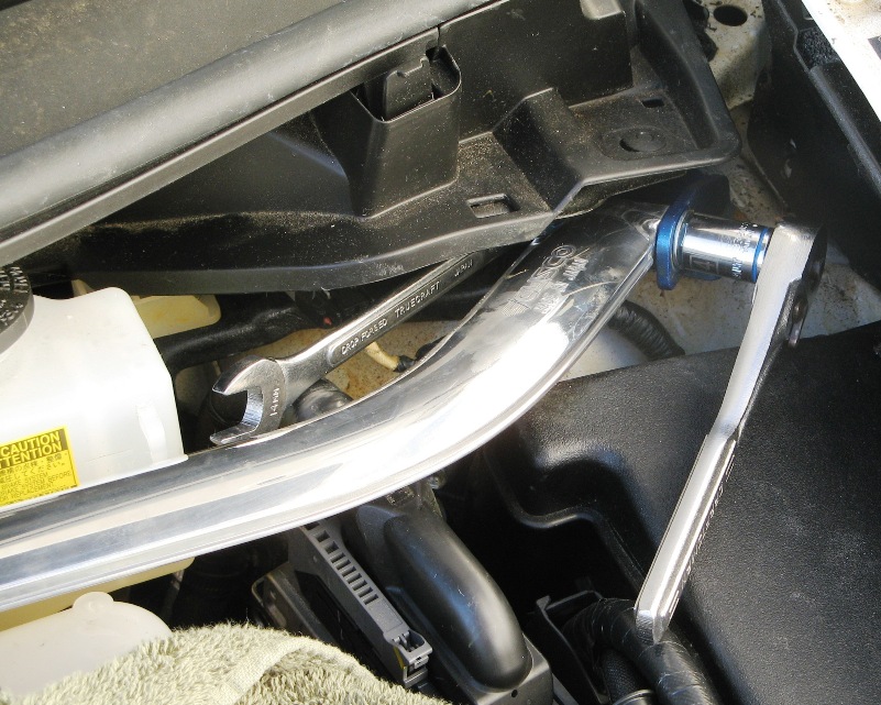

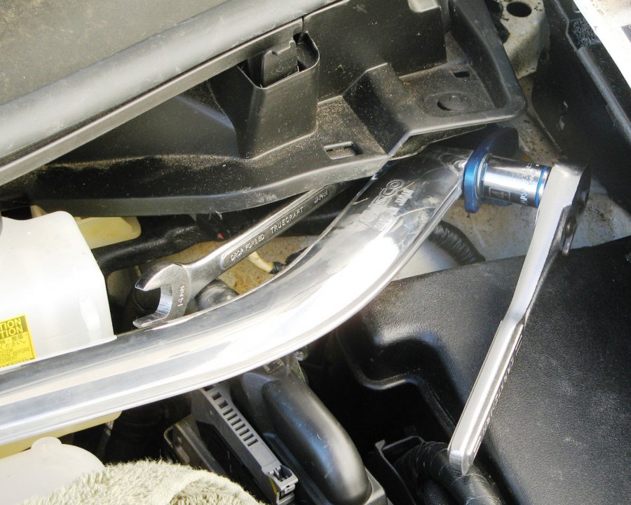

    Read the post by NoMoreHow on the one from HorsePowerFreaks. The one for $180 in the pictures is correct.
    I had a 65 degree day outside and did mine then.
    The back nuts are the toughest ones to get to. You loosen them until the are free spinning and work them off with a long thin flat blade screwdriver.
    I used a magnet, but a 10 inch long "hemostat" for about $12 delivered off of eBay, makes it simple to place the washers and nuts. I'd place the nut on the stud and carefully work it to start the threads with the long flat blade screwdriver.
    Once the nuts are run down, you need a long 14mm offset wrench like this cheap one off of Amazon to tighten them.
    It's also helpful for removing the nuts in the first place.

    It's not that hard, NoMoreHow,
    I just looked at the situation and though that the install procedure provided by Cusco was absurd.
    It's all about having the right tools and techniques. Over the years, I have acquired a good feel on what the proper torque is for a particular fastener. Many novices tighten bolts too tight.
    The particular tools that I noted are good to have anyway. They are not expensive and have a lot of other uses. The bolts provided by CUSCO needs an 8mm Allen wrench. How often does anyone use that? The 12mm x 14mm wrench, along with a 10mm wrench would take off 95% of all the hex bolts on a Prius. The oil drain plug uses the same 14mm wrench.
    Experience is about trying things and making mistakes. I've made my share of them.

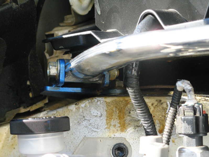

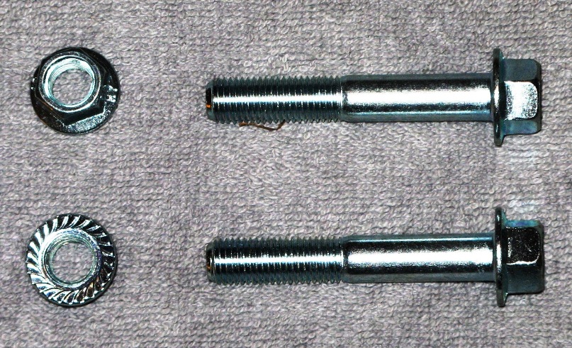

    OK, just installed my 14mm bolts. The changeout was not difficult using an open-ended 17mm wrench to grab the acorn nuts and the 8mm Allen wrench to break the threads loose from the front side.

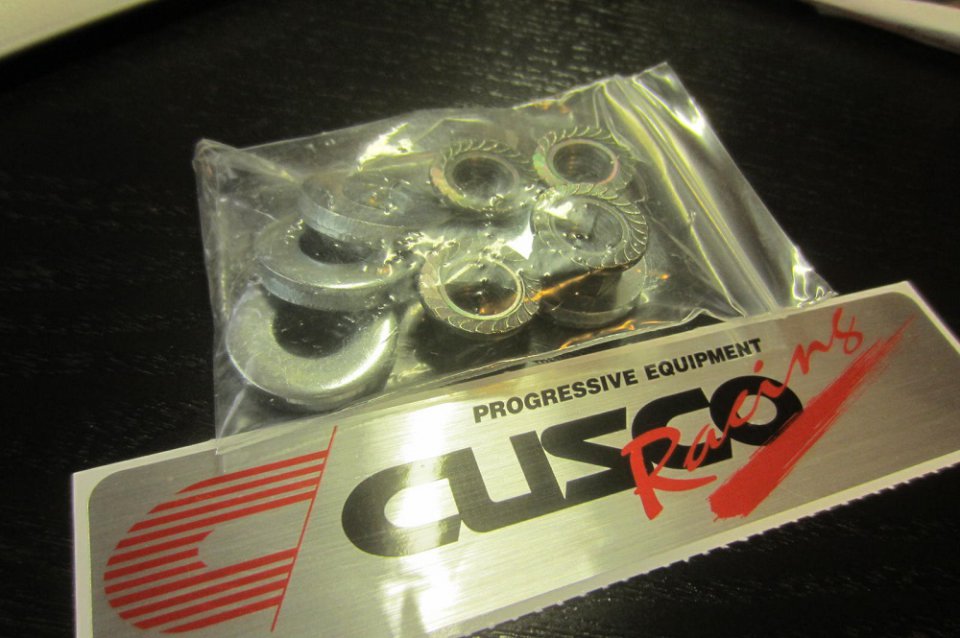

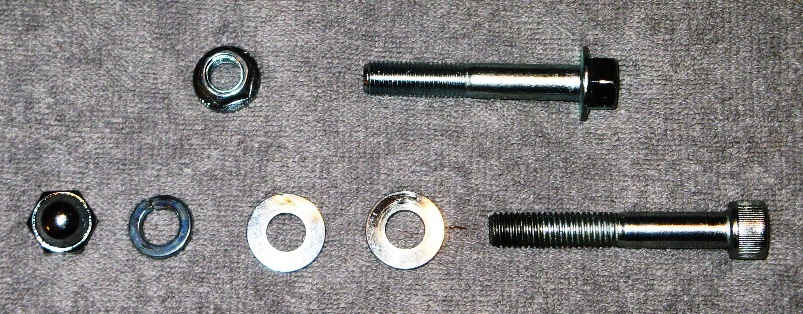

    Assembly modification: So as to easily put Loctite on the new 14mm bolt threads and not to lose the 14mm nuts in the very confined spaces behind the end hinge assemblies, I inserted the bolts starting from the inside (where the Cusco acorn nuts had been) and once each bolt was in place, it was easy to get Loctite onto the clearly visible threads now protruding on the outside end and then add the 14mm nuts, and then to bolt everything together. This is the reverse of what Rude person's did in the three pictures (nuts to the inside). The assembled unit functions in exactly the same way.

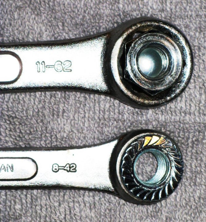

    I guess either way works just fine...
    I just like having the bolt heads on the outside. It makes for easier withdrawal, I guess.
    Two pieces on each side are easier to handle than the five supplied by CUSCO.

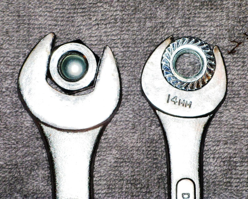

    And, you can use the ubiquitous 14mm wrenches commonly used for nuts and bolts throughout all Japanese and Korean branded cars.

    Here's more photos of the Improved 10.9 J.I.S. flange bolt and nut set...

    After fiddling with the cheap low grade 8mm hex key socket head screws, whose heads I deformed on tightening, and the non-J.I.S. large head 17mm on hex nuts and multiplicity of washers, I sourced out the special 10 grade flange nuts and 14mm hex 10.9 J.I.S. bolts. The NEW bolts and nuts are a pleasure to use. They use the same wrenches as the OEM bolts on the car.

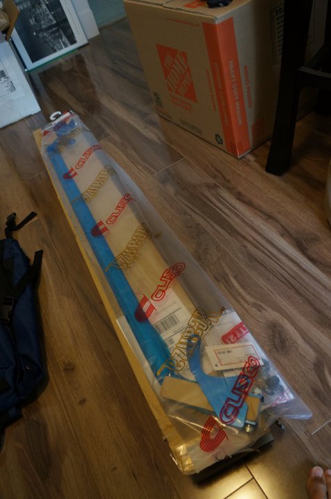

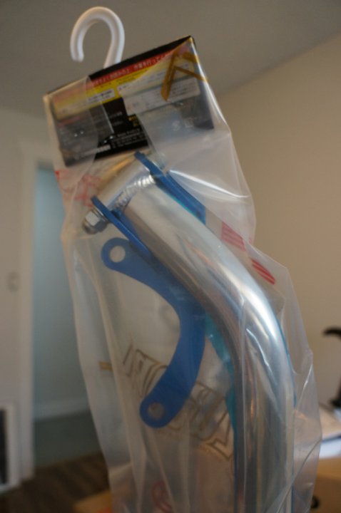

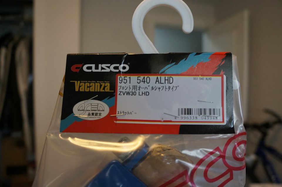

    So after almost 2 months of waiting, my Cusco front strut tie bar arrived from Horsepowerfreaks aka Vivid Racing. I have come to the realization that anything nice that you want for the Prius will take eons to arrive.
    It came in a box without any sort of advertisement. Is it a Chinese knock-off? lol.
    Alright, this is looking better. There is the word - Vacanza written all over the plastic. Isn't that the Prius Van?
    I can't read Japanese but I am happy to see that language on anything I buy !
    Hmm...where is the master cylinder brace thing?

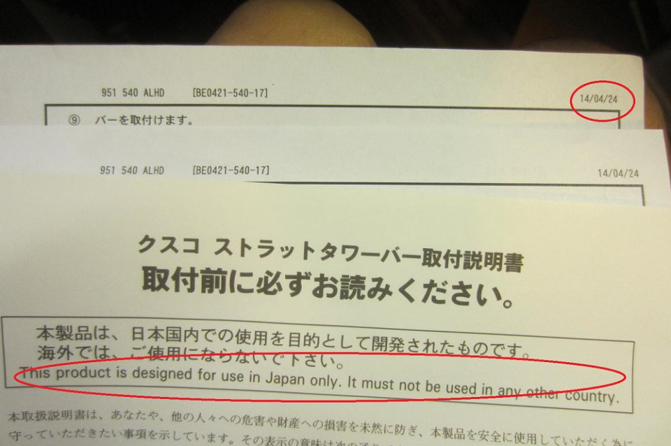

    Looks like there was a possible revision of this product as the date here is from sometime in April 2014
    Not sure if these washers are like the ones everyone else has on Previous versions of the bar. IMG_0002.jpg

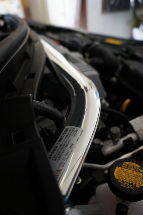

    Japanese on the front sticker just says:
    951 540 ALHD
    Front Use Oval Shaft Type
    ZVW30 LHD (chassis, left hand drive)
    Strut Bar
    I recall the Cusco parts catalog. This is the only model for LHD models for the ZVW30 Prii (which kinda makes the prohibition against using it outside Japan amusing--I believe they actually mean it's not warranted or supported if you use it outside Japan and it's just a bad translation. The "A" in "ALHD" refers to the shaft being aluminum as opposed to their carbon shaft models ("CS", I think) and stainless steel models ("SS"?), and it's an Oval-shaped cross section vs. some of the other cross-section types.
    The other options are moot anyway since, last I checked, they only make an LHD variant of the aluminum oval STB. And they don't list any type of rear STB for the Prius, even though they make them for other makes and models.

    Here's a link to the installation instructions in English.
    http://www.juicedhybrid.com/v/vspfiles/assets/images/951%20540%20alhd_eng.pdf
