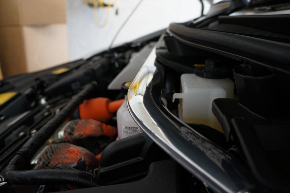

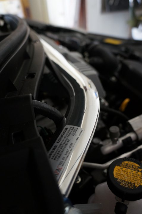

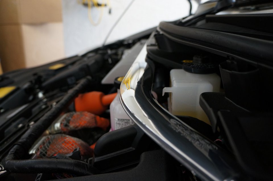

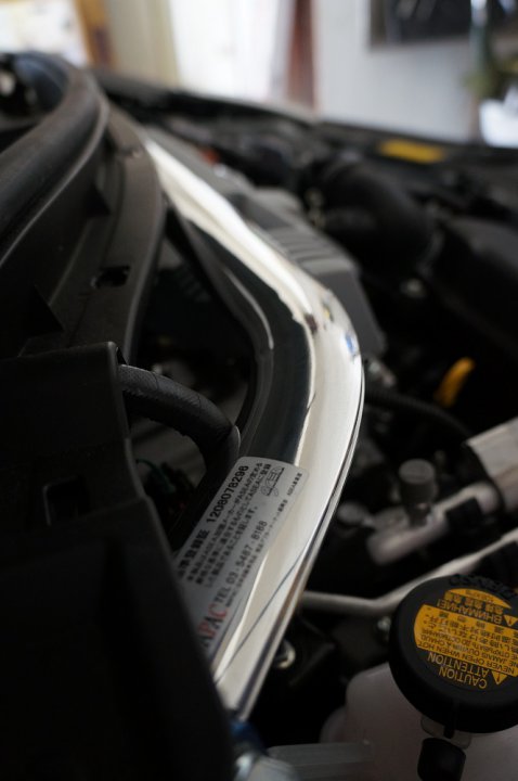

    @summit123 We are both on the same page with the design of the Cusco STB which is a very good and noticeable difference once the brace is installed.
    Being in the early Honda scene (1990's) there were a couple of JDM companies that provided a one piece design for bracing such as Mugen and Carbing - which are still around. They were expensive back in the day but well worth the money spent which was due to R&D that was done to get the best results.
    That's why I took the leap and purchased a TOMS STB for my Build

    Where did you get this STB, and how much was it?
    Was the install similar to the Cusco?
    I put one in my '97 Civic many moons ago. If I remember correctly, it was also one solid unit.

    The install was very similar to Cusco. Had to remove the wiper assembly for a direct one solid unit install without worrying about how much pre-tension that is needed for the Cusco and Tanabe - which are both good STB. The TOMS bar also gives enough room to access the fuse panel without performing a Whodini trick (Tanabe) o_O
    TOMS FRONT STRUT TOWER BAR TOYOTA PRIUS 2010-2015 + Plug-IN

    That's a nice one piece bar and it uses all of the strut bolts. I just installed the Cusco stb and love the precise steering it has given my 2013 Prius. I have the TRD springs and rsb, 17" wheels and low profile tires, Cusco mid and front braces and now the Cusco stb. Each items continues to add to the stability and fun I never imagined was possible from a Prius!!! The under chassis braces do transfer road vibration to the cabin so keep ride comfort in mind. Personally I love the extra road feel transferred to my seat. Next install waiting to be bolted on is the Cusco rear brace. I don't really expect to feel much from this but for $114 I figured what the heck. The parts all all super light too. Who knew our high mileage cars could be so fun to drive. Anybody add an Ultra Racing rear strut bar or back seat floor bar?
