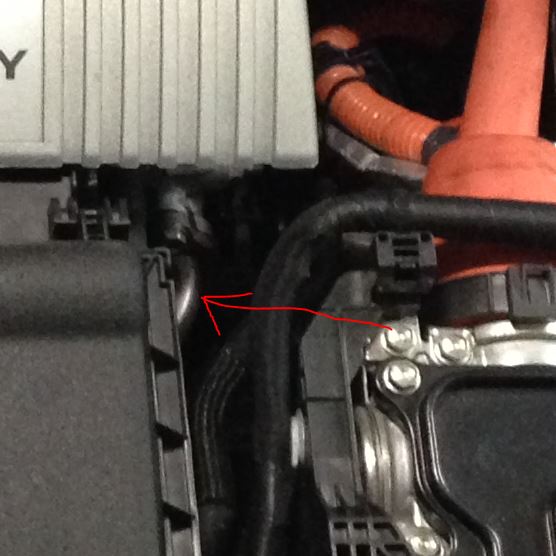

    Might be also build-up of tar/gunk in the Exhaust Gas Recirculation circuit, though with your miles seems a little soon. The canary-in-coal-mine could be the inside of this pipe. You need to take the air cleaner housing off to get at it, and the bolts at the nearest-to-you end are obscured by some plastic clips you have to remove for access. The clips are hard to release, but it's possible. You can just see the elbow of the pipe in this pic:

    I will check into that, thanks.
