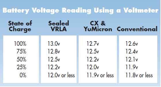

    Normally for conventional cars, the 12V battery (which is the Prius aux battery) voltage should read about 13.8 volts when new and about 13 volts when in good condition and about 12.5 volts when it needs to be replaced. If the Prius Aux battery works like a conventional car 12 vdc battery - then your Prius aux battery reading of 12.39v signals the need to replace it with a new battery. I've read in this forum that a bad/dying Prius Aux battery in the 1st and 2nd gen Prius will cause random and strange problems...

    Very untrue!
    Please edit the post and remove the glaring mistakes.

    Well, you didn't explain how you evaluated the 12V battery, but the voltage you provided is well below the fully charged battery.

    12v was checked at advance auto. They didn't know which cca to use but went with a standard 500. I have no idea what that is or what it should be for that battery. They rated it as good. The diagnostic check at the Toyota dealer also did not reveal a low battery.

    A mobile radio transmitter drawing from an automotive 12VDC line will need up to 13.8 VDC to output at its highest power level.
    I've read multiple times where the gen2 Prius onboard computer and sensors will exhibit erratic readings/behavior when the aux battery needs to be replaced. While a battery's state of charge (and ability to hold a power) is estimated by measureing the battery's voltage level - the amount of power/current level that a battery can sustain/provide will vary widely from the voltage level. However, usually as the voltage drops - so does the battery's ability to sustain a current level high enough to run its expected load. A battery may look find alone when tested with a voltimeter but still not be able to handle a circuit's load requirements.
