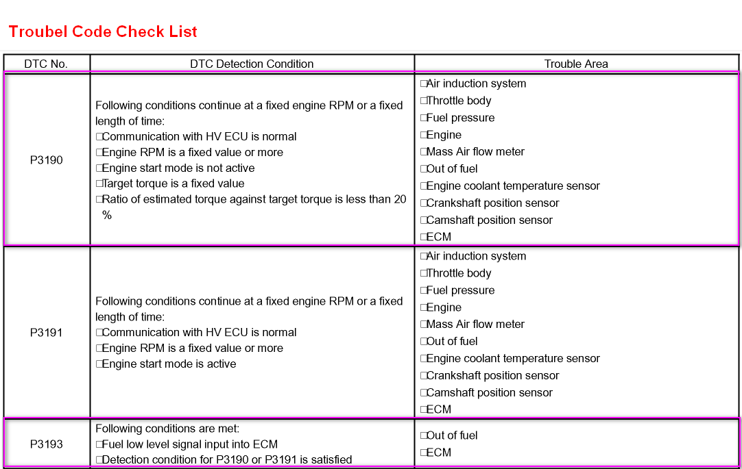

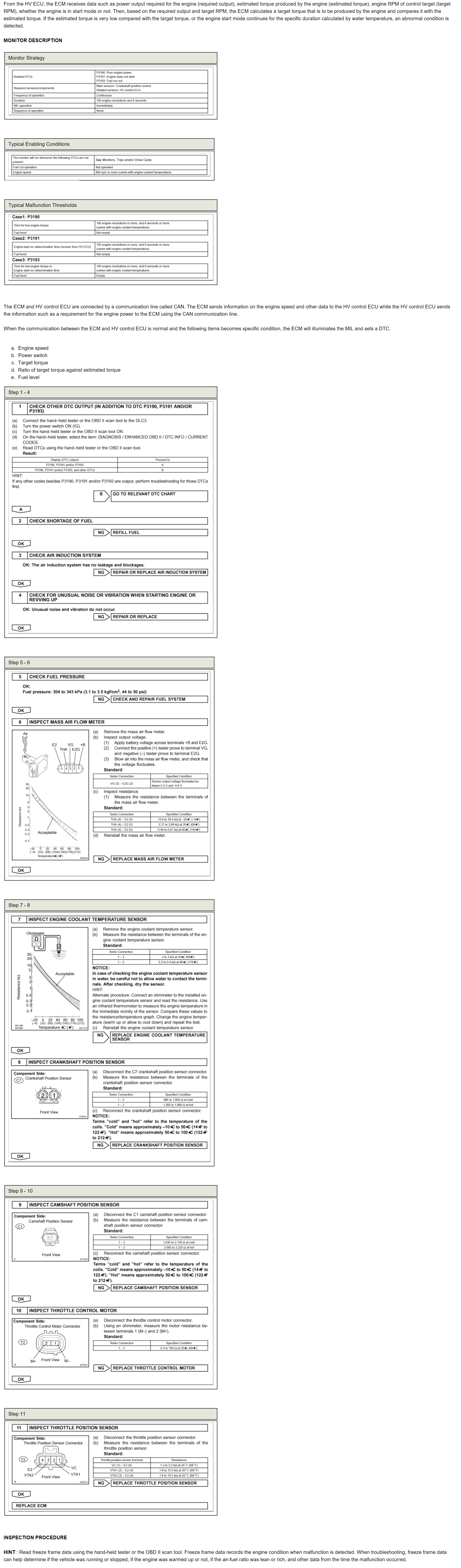

    Does that mechanic have a Toyota Hybrid compatible OBD code reader or did s/he share any codes with you?
    Assuming you are still working from the same thrown DTC (3190), here is a work up (and check list) for such.
