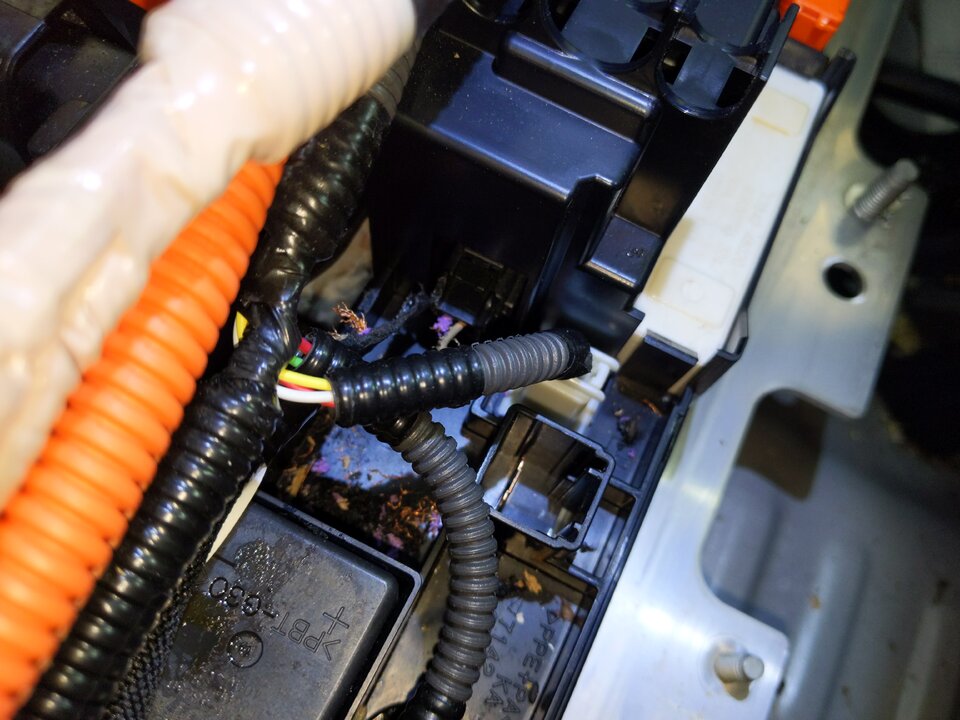

    Alright, we have an update! (We actually fixed it last Saturday, but I've been working long hours since and didn't have time to post an update)
    We uncovered the battery and explored how it's held together. There is a top cover held on by fasteners (bolts or nuts) at the front, back, left, and right. Take pictures before you disassemble and at each stage! Undo those fasteners and carefully remove the top cover. Be careful! This battery holds over 300 volts DC at exceedingly high amperage, and is more than enough to kill someone working on it. I don't recommend working on it if you are not already familiar with working around high voltages and know precautions to take, including (but not limited to!) working with one hand in your pocket, using insulated tools, and removing all metal jewelry before you start.
    You can now start carefully examining the battery for mouse damage -- we were sure we'd found it in a gnawed section of flexible plastic conduit, but when we looked at the wire itself, it was undamaged (and ohming it out confirmed this). Interestingly, when we used the DMM to check voltage between the positve and negative "contactors", there was 0 difference between them. Since we knew the cell voltage was healthy, it meant the remaining choice seemed to be the control circuitry effectively shutting down the battery.
    I had wanted to examine the relays at the front end of the HV battery, but couldn't figure out how to get them out. While pondering this, I saw another relay, and then saw -- behind it! There's our problem, two wires that mice had just chewed all the way through and entirely disconnected from the wiring harness. They're right around the middle of the picture.
    "Sighted circuit, soldered same, success" - praise God!
  5. ChapmanF
    28,705
    19,007
    Hmm, the "− contactor control circuit", the exact subject of the P0AE0 trouble code!
    To those who say it's never much help looking up the trouble codes, I say, behold!
