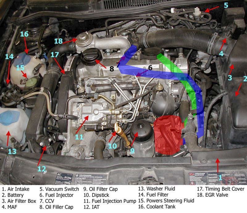

    It is possible to get right - my old TDI had this setup:
    You'd lift the cap with the element out, with something to catch the oil, and then pull the element off the cap, replace a couple O-rings, put the new element on, and drop the cap back in.

    Just a simple nut of some sort holding the oil filter cap on? Absurdly simple and effective.
