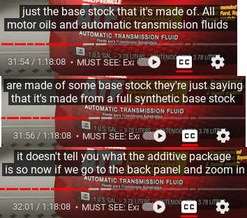

    I've just spent not quite ten minutes (I bumped the speed up) watching those ten minutes of the video to see where he said that, but I don't believe he said the base stock doesn't matter, or even that the additive package matters more. What he says turns out to be here:
    and all he appears to be saying is that the base is not the only thing that matters.
    What you're looking for is a product that passes a particular whole suite of tests specified by a manufacturer. Simply being told that a product is synthetic doesn't tell you that.
    Even if a product would have to be synthetic in order to pass all the tests (which might be the case), just being told "hey this product is synthetic" is nice to know but not enough; the question is still "does it pass all the tests?".
    It's like if you're deciding whether to accept a $100 bill from me, and you know it had better be printed on rag stock, with green and black ink, and signed by the US treasurer and treasury secretary.
    If I hand you a thing printed on rag stock, that by itself doesn't make it a $100 bill. In saying that, I'm not saying the stock doesn't matter, and I'm not saying the ink matters more. I'm just saying it's not a Benjamin unless all the specifications are met.
