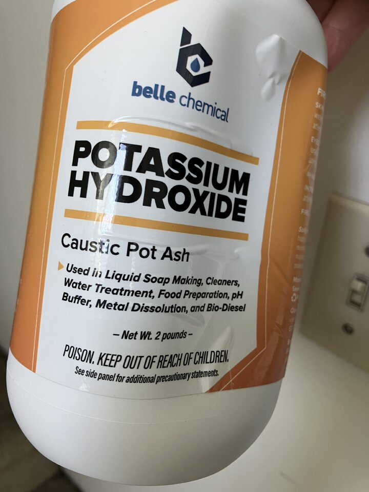

    An update: we had a bottle of “lye” crystals, an Amazon purchase for a soap making project (which so far hasn’t happened), that turned out to not be lye (sodium hydroxide, NaOH), was in fact this:
    (Caustic Potash, Potassium hydroxide, KOH)
    Which after my initial dismay, with a little reading, I see is similar in efficacy, even more caustic, easier to dissolve in water as well.

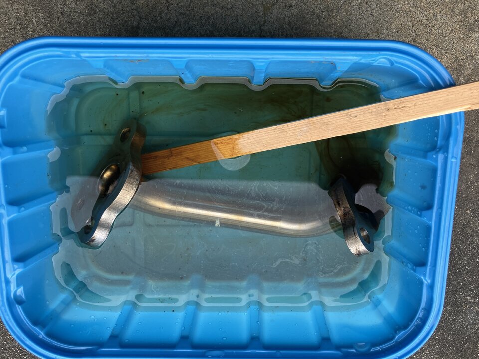

    I had the EGR pipe out a few days back (cleaning oil catch cans, throttle body, PCV valve and intake manifold), so thought I’d try the pipe with KOH solution. Even at just 10% by weight solution, quite effective after about a minute:
    I think 20~30% would even more effective. 40% is approaching saturated, fwiw.
    Again, read up on this stuff, it’s strongly caustic, handle with care and take appropriate safety precautions.
