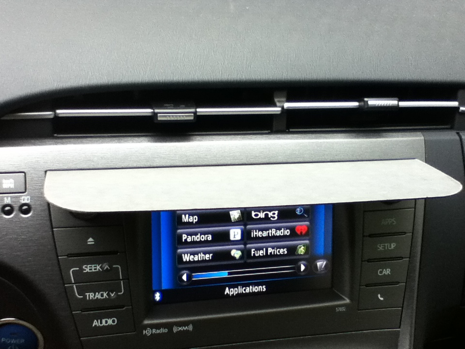

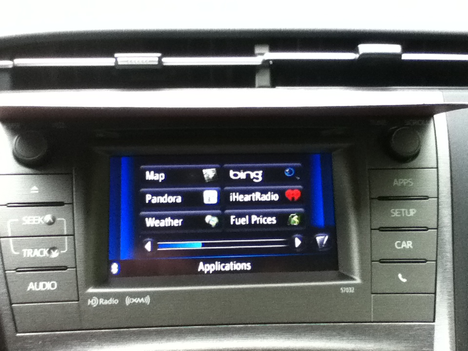

    Like many others, I was finding glare on the navigation screen disconcerting. While beginning to consider purchasing a commercial aftermarket visor, I improvised a temporary solution that works well enough that I may never replace it.
    It is made from a dense piece of mat board scrap that measures 3" x 10 3/4" x .048" (1.25 mm) thick. The corners are rounded and the back edge (which simply wedges in the crack above the audio/nav unit) is slightly eased with fine sandpaper for easer insertion. It only goes in about a quarter of an inch, but fits snug and secure in the seam.
    All controls remain accessible and the CD slot is functional, albeit a bit crowded. It does a decent job of keeping direct sunlight off the screen from all but the lowest angles, even without "wings". My scrap piece happened to be charcoal / maroon so I didn't even need to color it to blend in nicely with the dash materials.
    Hey, it's nothing fancy, but it does the job and you can't hardly beat the price!

    This is awesome. I just got my Prius on Saturday and the glare has been driving me nuts, glad to know I'm not the only one.

    I was going to stick something in the CD slot, but I like this a lot better. Nice!

    I bought a new bathroom scale the other day and still had the box it came in. Just so happens that the cardboard was the right thickness and I made a visor just like the one shown above. I don't know how it's going to hold up over time, but I've got enough cardboard to make 6. If the cardboard doesn't hold up, I'll look for a piece of plastic at Hobby Lobby or Michael's. I noticed one of the commercial hoods has wings on the end folded down for a sidewall and extra rigidity. I prefer something soft because that would be less dangerous in an accident.

    Just want to say Thanks for this suggestion. My cardboard visor is working great on our trip.

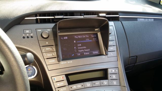

    Here's mine that I posted awhile back, this mod is really needed esp. if your in socal. Got it off amazon, velcro it to dash for easy removal.

    What I did was break off those tabs, then unscrew the 4 screws of the plate, and flip it so it is smooth against the surface of the dashboard.
