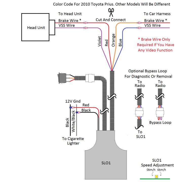

    New Speed Lock Override SLO1
    Edit: V1, V1V, V3,V3V have been discontinued. Info has been moved to post # 9
    The new Speed Lock Override SLO1 and the new Turn Signal Hazard Rear Camera Activation+Speed Lock Override TSHRCA+SLO1 are now available for order at Toyota Prius Turn Signal / Hazard Rear Camera Activation Kit w/ Navigation Override - All Models - PriusChat Shop Please chose the correct model when ordering.
    There's no expedited shipping. All orders get ship the same method regardless of what shipping method you've chosen.
    Starting in April 2015, new customers will have access to user updatable installation instruction. If you can make the instruction easier to understand with better pictures, you can update it. If you haven't installed your override, contact me for the latest instruction. Meanwhile, check out These V1 instructions. SLO1 instructions are the same except the override's output colors.
    Click here for installation instruction for 2010-2014 Prius hatchback, 2012-2015 wiring starts on page 8
    Click here for installation instruction for Prius v posted by anewhouse and russcarver - First Navigation Speed Lock Override (from the PC shop) in a Prius v: SUCCESS! | PriusChat
    Click here for wiring information Some Of these Information Is Not Accurate. I Will Update As Soon As I Can

    Do I have to hook up the red wire and the orange wire for the brake?
    No, IF your vehicle doesn't have any type of video functions such as DVD playback or video input. Or, if you're not interested in DVD playback while in motion.
    Yes, IF your vehicle has any type of video functions such as DVD playback or video input.
    If you still don't know, operate your head unit with the parking brake on then again off. If there are functions that's only available with the parking brake on then you must hook up the parking brake switching wires.
    Updated 4/16/15

    What speed does the override simulate? Updated 8-19-14
    SLO1 is adjustable between 0km/h - 6km/h. Less than 8km/h enables all the grayed out buttons.

    10-15-12 Added wiring info
