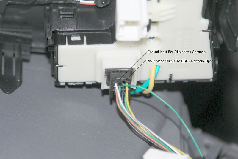

    I am starting this thread for supporting the up coming PWR mode mod in PriusChat Shop.

    How does this mod work?
    PWR mode can be activated after the Prius ECUs have powered up, usually about 1.5 to 2.5 seconds after you push the POWER button on the dash. This mod mimics the delay necessary to activate the PWR mode. Without this delay, the vehicle will not switch into PWR mode. The delay is adjustable between 0 and 5 seconds. Once it is adjusted to the correct delay, it will work every time. If it doesn't, readjust to a longer delay until it triggers the PWR mode every time.

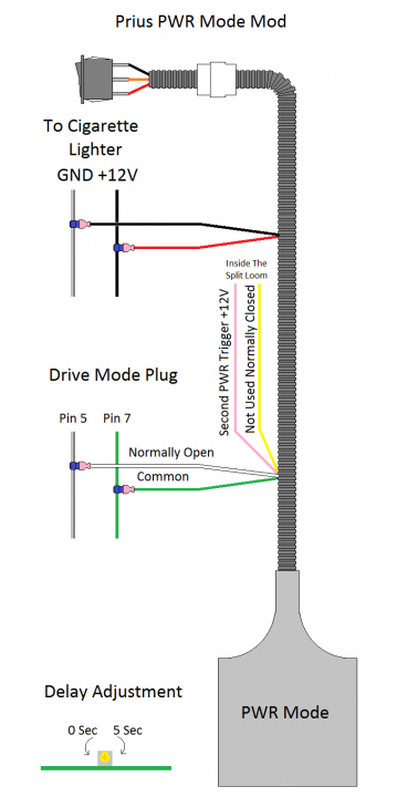

    How do I install this? As of this writing, there's no installation instructions. The basic steps for the Prius HB are
    1. Remove necessary center console panels.
    2. T-Tap the PWR wire.
    3. Route the power, ground and trigger wires to lower cigarette lighter panel and hook up power and ground.
    4. Route switch harness to blank filler and mount the switch.
    It should take less than 1 hour to do. No wire cutting necessary, only T-Taps.

    2010-2014 Prius Wiring Info
    Wiring Diagram Based On 2010 Prius. I have no information for Prius v at this time.
